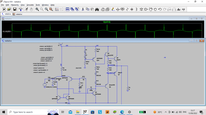

Attached is a screenshot of an amp I am running in Ltspice. There are spikes on all the currents and voltages displayed, can anybody tell me why?

The component values are too blurry to read, but when I follow the schematic in my head with typical values, the topology seems OK. My guess would be that you are seeing a dead-band and step during each crossover of the output stage, that is being fed back and around the loop. I suspect your selection of component values is the problem, rather than the simulation parameters.
Likes Tom.G and DaveE
Crossover distortion are the cause of this spikes. Too low output stage quiescent current.

Audi_amp_bjt_1 seems to have got rid of the spikes (thank you) but why are the base, collector and emitter currents of Q3 so ugly, is this normal? Also, the current shapes of Q4 and Q5 don't look the best either but are beautifully righted in Q6 and Q7, is this too normal?

The Advanced Amplifier is a learning exercise, not a practical optimised audio circuit.
One problem with Audi_amp_bjt-1.asc is that the feedback is taken from the second last stage, not from the output. Another is that, to reduce crossover distortion, the output stage has a quiescent current of 800 mA, without any current limit to prevent the catastrophic thermal runaway. You need a checklist of parameters to verify, so when you optimise a design, you do not end up with something like 800 mA quiescent in the output stage.

In the mirror circuit the collector currents of Q1 and Q2 are 180 degrees out of phase whereas in the advanced amp circuit they are not. Any ideas why?
The collector currents in the mirror should be in phase. The collector currents in the differential pair should be out of phase. You must be careful how you specify and measure currents because currents can be reversed by reversing a component.
