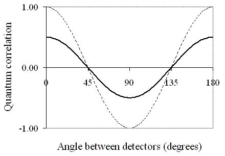

It seems that the large number of photons should be identical to result of the large statistical sample of individual photons.
The article in wiki (see below) talks about Malus' Law and Bell theorem, but I am not sure if this article conforms or rejects this link.
http://en.wikipedia.org/wiki/Local_hidden_variable_theory
"Optical models deviating from Malus' Law
If we make realistic (wave-based) assumptions regarding the behavior of light on encountering polarisers and photodetectors, we find that we are not compelled to accept that the probability of detection will reflect Malus' Law exactly."
However this isn't my main concern. My biggest problem with the Bell theorem is that I don't understand the origin of the red line: how the unlimited scenarios of possible complex hidden variables is transformed into two simple strait lines. Unfortunately I wasn't able to find the comprehensive for a layman description of this transformation.

My biggest problem with the Bell theorem is that I don't understand the origin of the red line: how the unlimited scenarios of possible complex hidden variables is transformed into two simple straight lines. Unfortunately I wasn't able to find the comprehensive for a layman description of this transformation.
If you haven't already found DrChinese's web page, give it a try: http://www.drchinese.com/Bells_Theorem.htm
  • #68
Miosim,
http://www.drchinese.com/David/Bell_Theorem_Negative_Probabilities.htm
A. Figure 3 at the above link is very similar to the graph you presented, but instead for photons. The analogy is as follows: what does QM predict for matches for an angle difference between Alice and Bob's setting (blue line); what realistic prediction comes closest to QM (red line). The Red Line must not lead to logical contradictions such as negative probabilities, probabilities in excess of 100%, violations of CHSH etc.
There is no guarantee that the Red Line is the ONLY possible line to compare to the Blue line. But at least it is "sorta close" to the QM prediction. And you can easily see that it does NOT match the QM expectation except at zero and a few other special cases.
B. In my example at the above link, I choose A=0, B=67.5, C=45 degrees. Keeping A and C constant, and varying B only, gives the following function:
f(B)=(cos^2(B-0)+sin^(45-0)-cos^2(B-45))/2 which corresponds to the sum of the likelihood of 2 particular realistic cases occurring. These 2 cases have NO relevance in QM (they don't exist), and are simply an arbitrary formula otherwise - like the CHSH inequality. But f(B) is negative for any value between 45 degrees and 90 degrees exclusive, which means the QM prediction (if matched by a local realistic theory somehow) would predict a negative likelihood for those cases (which is obviously absurd).
C. On the other hand, if you plugged the red line prediction in instead, you would NOT get negative values. But it would not agree with experiment, because it is different than the QM expectation (because the Blue line and Red line are different).
To summarize: if the Blue line is the LR prediction, you get a variance with experiment. If the Blue line were to be the LR prediction, you get absurd results (negative probabilities). But again, agreeing with what you are saying, the Blue line is only ONE of the "unlimited scenarios of possible complex hidden variables". But every one of those will reduce to either B. or C. eventually, so you always return to the same point.

The red line is not the only possibility for a local realistic theory. It's just that it is the prediction for a very specific locally realistic model that agrees with QM at the points \theta = 0^o, 90^o, 180^o, 270^o, 360^o.
As DrChinese pointed out this particular model is not very plausible, for other reasons.

Reading the wiki link http://en.wikipedia.org/wiki/Local_hidden_variable_theory provided on your page I found the following graph:
Fig. 2: The realist prediction (solid curve) for quantum correlation in an optical Bell test. The quantum-mechanical prediction is the dotted curveIn this article the relation between Malus Law and predictions are mentioned multiple times (see below), but I still can't grasp their exact relationship.
1). In optical experiments using polarisation, for instance, the natural assumption is that it is a cosine-squared function, corresponding to adherence to Malus' Law."
2). If we make realistic (wave-based) assumptions regarding the behaviour of light on encountering polarisers and photodetectors, we find that we are not compelled to accept that the probability of detection will reflect Malus' Law exactly
3). By varying our assumptions, it seems possible that the realist prediction could approach the quantum-mechanical one within the limits of
experimental error (Marshall, 1983), though clearly a compromise must be reached. We have to match both the behaviour of the individual light beam on passage through a polariser and the observed coincidence curves. The former would be expected to follow Malus' Law fairly closely, though experimental evidence here is not so easy to obtain. We are interested in the behaviour of very weak light and the law may be slightly different from that of stronger light.
My question is:
What is exact (theoretical) relation between QM predictions, realistic predictions and Malus law.
Thanks

I am retrieving my question because I realized how wrong it is. Indeed, the "the red line" is for spin particles and not for polarized photons.
My question is:
My question is:
Solid curve is the prediction based on Malus' law. It's 1/2 from QM prediction. To get that I think you work out independent probabilities where Pa(+) = Pb(+) and Pab(+ and +) = Pa(+)Pb(+).
I think to check Malus' law all we need is to look at Alice and Bob's readings individually. Total number of "+" should be about the same as "-" no matter what angle settings is at either Alice or Bob's analyzer. I don't see why would that not be easy to verify, but I also don't see that would change anything because it says nothing about how the two readings are supposed to match against each other. In local theory there is no any connection between the two events so the rest is in the hands of probability theory, and because the two events are supposed to be independent we use the equation for independent probabilities: P(A and B) = P(A)P(B), which leads to that solid cure. Or something like that, I'm not quite sure how to work out the integral.
No, a local theory doesn't imply independence of the results, and it does not imply P(A and B) = P(A)P(B). The reason why not is that even though A can't influence B, and B can't influence A, there might be a third cause that influences both. That's what the "local hidden variables" idea is all about: whether the correlations can be explained by assuming that there is a cause (the hidden variable) that influences both measurements.
A locally realistic model based on Malus' law is this: assume that in the twin-photon version of EPR, two photons are created with the same random polarization angle \phi. If Alice's filter is at angle \alpha then she detects a photon with probability cos^2(\alpha - \phi). Similarly, if Bob's filter is at angle \beta, then he detects a photon with probability cos^2(\alpha - \phi). The correlation E(\alpha, \beta) would then be:
E(\alpha, \beta) = P_{++} + P_{--} - P_{+-} - P_{-+}
where P_{++} is the probability both Alice and Bob detect a photon, P_{+-} is the probability Alice detects one and Bob doesn't, etc.
For this model,
P_{++} = \frac{1}{\pi} \int d\phi cos^2(\alpha - \phi) cos^2(\beta - \phi) = \frac{1}{8} + \frac{1}{4}cos^2(\alpha - \beta)
P_{+-} = \frac{1}{\pi} \int d\phi cos^2(\alpha - \phi) sin^2(\beta - \phi) = \frac{1}{8} + \frac{1}{4}sin^2(\alpha - \beta)
P_{-+} = \frac{1}{\pi} \int d\phi sin^2(\alpha - \phi) cos^2(\beta - \phi) = \frac{1}{8} + \frac{1}{4}sin^2(\alpha - \beta)
P_{--} = \frac{1}{\pi} \int d\phi sin^2(\alpha - \phi) sin^2(\beta - \phi) = \frac{1}{8} + \frac{1}{4}cos^2(\alpha - \beta)
So
E(\alpha, \beta) = \frac{1}{2}(cos^2(\alpha - \beta) - sin^2(\alpha - \beta)) = \frac{1}{2} cos(2 (\alpha - \beta))
That's exactly 1/2 of the QM prediction.
