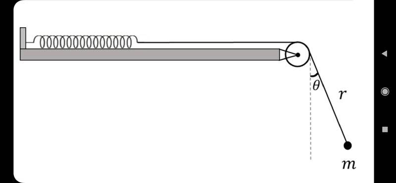

I'm stuck in a problem of a spring mass system with a pendulum attached to it as showed in the figure below:
My goal is to find the movement equation for the mass, using Lagrangian dynamics.
If the spring moves, the wire will move the same amount. Therefore, we can write the x and y position of the mass in terms of this displacement, the length of the wire, and the theta angle.
The problem I'm having is getting to identify the potential energy of the spring, using these terms so that when solving the LaGrange equation it gives a restoring force term of the spring.
Can anyone help me identifying this?

I am not very good in Lagrangian mechanics but if we use $$r(t),\theta(t)$$ for the position of the mass, then the contribution to Lagrangian from the potential energy of the spring should be $$\frac{1}{2}k((r(t)-r(0))^2$$ assuming that at t=0 the spring is at its natural length.
I believe there is more to the Lagrangian from the gravitational potential energy of the mass.

I like @Delta2 ‘s suggestion. Treat ##r(0)## as the natural spring/wire length and ##r(t)## as the new length. Then the spring potential energy is exactly what he mentioned. Just add a gravitational term ##mg(r(t)-r(0))## and you've fully formed your Lagrangian.
Edit: You still have to form your kinetic terms.

I think the gravitational potential energy depends on ##\theta## too.

I really ought to start thinking before I start posting. Of course you are right. Tack on a ##\cos \theta##.

It's not usual to express the quantities in a Lagrangian as a function of time, as these are quantities associated with a configuration space. In fact, in the Lagrangian formalism it's important that they are not the time dependent quantities associated with the system's evolution, but abstract quantities in configuration space.
The gravitational term depends on ##r## and ##\theta##.
