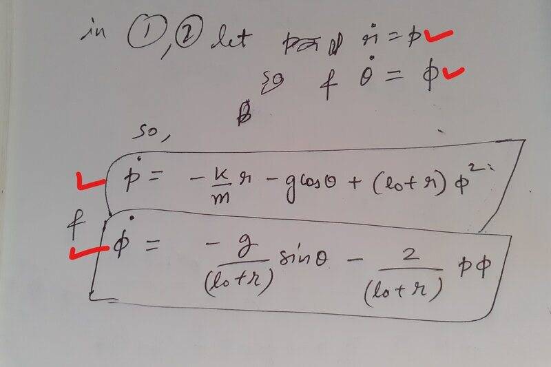

I have checked the program several times the program is running but the graphs I am getting is not what I was accepting soon one of the variables approaches zero I don't know why is it happening. The program I have made is below and it's in the FORTRAN language. If anyone knows Fortran can they please help me it's really very important for my project work?

These are the four equations I have used (actually they are two 2nd order ordinary differential equation but i have to convert it into four equations to do the programming)
if anyone finds anything please help me

Shouldn’t the sign of xd in function e be Negative?
Get rid of the implicit none!
On line 97, you mistyped xc as cx.
no actually there was a mistake the sign in the program is all ok but the picture sign was incorrect and finally after reviewing it again i got the mistake which is that in place of xc i used cx very silly but vital mistake.
