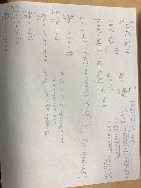

Now for the Lagrangian approach.
$$ L=T-V \rightarrow L= \frac{1}{2} m(\dot l^2+l^2\dot \theta^2)-mgy -U_{sp} \rightarrow L= \frac{1}{2} m(\dot l^2+l^2\dot \theta^2)+mgl\cos\theta -U_{sp}$$
Where
$$ U_{sp} = -W = - \int_{l_0}^{l(t)} \vec F_{sp} \cdot d\vec l $$
Carrying out the integration over a straight line (I haven't really dealt with line integrals before; I'm 'improvising' here since I haven't learned the theory of multivariable real-valued functions yet)
$$ U_{sp} = \int_{l_0}^{l(t)} k(l(t)-l_{eq})dl = (\frac{1}{2} k l^2(t)-l_{eq}l)-(\frac{1}{2}kl_0^2-l_{eq}l_0) $$
For aesthetic's sake, let ## \gamma_0 = -(\frac{1}{2}kl_0^2-l_{eq}l_0) ##
So our Lagrangian is
$$ L=\frac{1}{2} m(\dot l^2+l^2\dot \theta^2)+mgl\cos\theta-(\frac{1}{2} k l^2(t)-l_{eq}l)-\gamma_0 $$
Let the derivatives begin. I will include an image of the computation; if you would like this in LaTeX, let me know.
Which results in the equations of motion:
$$ m \ddot l -(m(\dot \theta)^2-k)l-mg\cos\theta-l_{eq}=-\alpha\dot l $$
$$ ml^2\ddot \theta +mgl\sin\theta = -\alpha l^2 \dot \theta $$
  • Why are the two sets of motion equations different? Shouldn't they give the same result?
  • For the Newtonian approach, does the drag force have both a radial and angular component or just an angular one? (See discussion above for more)

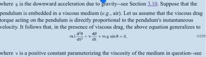

Also, I'v read a little bit of Fitzpatrick's chapter on the chaotic pendulum where he analyzes the simple pendulum with drag. I realize this thread is related to the spring pendulum with drag proportional to v^2, but I'll include how he analyzes drag (where he uses the proportional model rather than v^2 model) since it may shed light on this problem.
See the uploaded image for the equations of motion from Fitzpatrick. It appears he is using v as a drag coefficient. So that we don't confuse this with velocity, I'll redefine it as ## \beta ##.
$$ \vec F_{drag} = -\beta |\vec v| \hat v $$
For the simple pendulum, we have
$$ \vec F_{drag} =- \beta R\dot \theta\hat \theta $$
where I have not kept the absolute value on the theta dot after taking the magnitude. This is because if theta dot is positive, then the velocity vector is parallel to ## \hat \theta ##, thus making drag negative. If theta dot is negative, then drag will be parallel to ## \hat \theta ## and thus there is no need for plus-minuses. This finally makes sense to me. Thus, the equations of motion are those obtained in the picture below. However, it does seem that he doesn't include the R (l in the picture) on the drag force. Is that part of the drag coefficient?
However, for this problem, do I have to consider the radial components of the drag force since the length of the spring changes (see questions in the previous post, also)?

Ah yes, thank you for pointing that out. This makes more sense now; velocity will only be parallel/anti-parallel to ## \hat \theta ## if the position vector is normal to the trajectory. I suppose some of my sketching led me astray. Of course it may happen that at some points along the trajectory the position vector may be normal or tangent to the trajectory (resulting in the velocity just having an angular or radial component, respectively), but we don't know this until we analyze the equations of motion to see when ## \dot l## or ## \dot \theta ## are 0.
Nevertheless, I think - but I am not sure - that my mistake lies with my solution using the Lagrangian approach as I am now fairly confident in the Newtonian equations of motion (one can never be too confident I suppose, as it is very easy to lose track of a minus sign, an all-too common occurrence).
zwierz said:
I did not check the text; just a single remark
$$Q_j=\Big(\boldsymbol F_{drag},\frac{\partial\boldsymbol v}{\partial \dot q_j}\Big)$$
I used ## Q_j = - \frac{\partial |\vec F_{drag}|}{\partial \dot q_j} ## where I used the drag equation that was mentioned earlier (and used in the Newtonian approach):
$$ \vec F_{drag} = - \frac{1}{2} \alpha |\vec v|^2 \hat v= -\frac{1}{2} \alpha (\dot l^2+l^2\dot \theta^2) \frac{\dot l \hat r+l\dot \theta \hat \theta}{\sqrt{\dot l^2+l^2\dot \theta^2}} = -\frac{1}{2} \alpha \sqrt{\dot l^2+l^2\dot \theta^2}(\dot l \hat r+l\dot \theta \hat \theta) $$

StudentOfScience said:
I used Qj=−∂|⃗Fdrag|∂˙qj Q_j = - \frac{\partial |\vec F_{drag}|}{\partial \dot q_j}
that is wrong
Unfortunately in courses of mechanics it is paid very few attention to generalized forces. So students commit many errors while calculating the generalized forces in different problems.
Especially this concerns to problems with rigid bodies. For the case of particles formulas for calculating of generalized forces are well known and mentioned in many places.
