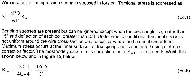

The wire in coil springs loaded in tension or compression is stressed in torsion. The spring wire may be either prestressed or not, depending on the manufacturing process.
A good discussion of spring stresses is in Fundamentals of Spring Design, by Spring Manufacturers Institute: https://smihq.org/store/ViewProduct.aspx?id=8088348. This should answer your questions. From an earlier edition of Fundamentals of Spring Design:
If you want to know more, the definitive source on spring design and internal stress is Mechanical Springs, by A.M. Wahl: https://smihq.org/store/viewproduct.aspx?id=8088306.

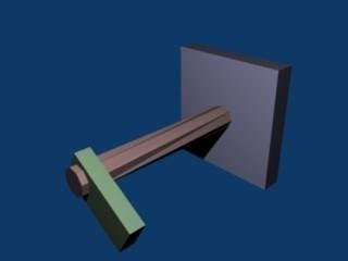

Ok, so let's take a mathematical helix, a curve which has both constant curvature and torsion.
1) The more curvature a curve has, the less straight it is. The more torsion the curve has, the less planar it is. When we elongate a helix, I guess its torsion increases and its curvature decreases.
2) When I think of torsion, I think of twisting something using shear stress to deform it permanently or temporarily.
Back to springs, elongating a spring produces more torsion. I see how torsion increases given the mathematical definition of torsion: the piece of the spring get more distant from each other...still the straight metal wire making the spring that we started with has the same material and same overall length as the spring. Having deformed it into the helical shape, we have essentially convert it into something with very different properties...
