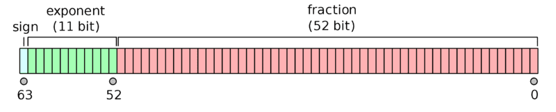

15 digits of precision displayed, followed by zeroes. The underlying implementation is 64 bit floating point. Apparently rounded to 15 decimal digits.

The IEEE 754 Standard for floating point 64-bit numbers maintains slightly over 15 decimal digit precision. See https://en.wikipedia.org/wiki/IEEE_754.

Expressed in binary, the product 111111111*111111111 has 54 bits. IEEE 754 can express 53 (counting one extra "hidden" bit from normalization). Here is the true mathematical result for the product. [Result obtained from Windows calculator, programmer mode]
Code:
10 1011 1101 1100 0101 0100 0110 0010 1001 0001 1111 0100 1011 0001
 <---------------------------- 52 bits -------------------------->
One "hidden" bit from normalization           One bit not expressed
IEEE 754 64 bit can exactly express the number one greater than this and the number one less than this. Those two are both "model numbers" within the floating point format. But the mathematically correct result is not a model number. IEEE 754 64 bit cannot express the product exactly.
