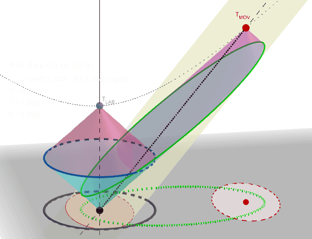

The geometry involved in your scenario is encoded somewhere in this spacetime diagram
from my interactive visualization of circular light clocks: https://www.geogebra.org/m/pr63mk3j .
Some analysis is needed to identify the appropriate construction and set up the calculation.
