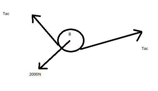

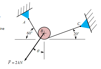

Attached is the picture of the problem and my free body diagram.
The system is in equilibrium.
Fy = 0 Fx = 0
I'm having trouble solving the two equations that I arrive with...
I use +x to the right, and +y up.
For the forces in x: -TacCos(60) + TacCos(20) - 2000Sin(theta) = 0
For the forces in y: TacSin(60) + TacSin(20) - 2000Cos(theta) = 0
When trying to solve these two equations, I tried adding them together and setting them equal to each other but I've had no luck. What am I doing wrong or missing here?
