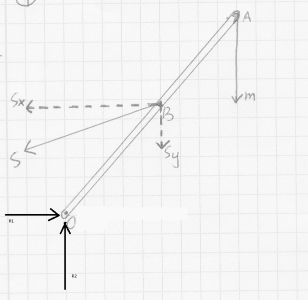

There isn't much data, I'm just supposed to simplify the drawing of the body OA and find the forces. The body has a mass m and is connected to the ground with a moving joint in O.
Below I post the drawing that I made. I changed the line into a force S, which I then divided into Sx and Sy. I don't know if there is anything else that I can do, but that's how far I went as for now.
ΣF=0
ΣM=0
ΣFx=> Sx=0
ΣFy=> Sy+m=0
Mo= Sx-Sy+m=0, I replace Sx with 0 (equation 1) => -Sy+m=0
I really hope someone will help me out on this one, because I'm totally stuck and don't know what else to do. Thank you in advance.

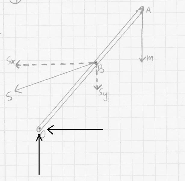

Yes the rotation does happen around the hinge. But there will also be vertical and horizontal reactions at the hinge point
Likes mechanim
Thank you!
In this case, the drawing would look something like that:
And if the vertical force is F1 and horizontal force is F2, then the calculations would change to:
ΣFx=> -Sx - F2 = 0
ΣFy=> F1 - Sy - m = 0
Mo= m+Sy-F1+F2+Sx=0
Am I right?

I just thought of something, here's the latest drawing I just made:
I also decided to call the distance between A and O "a" and the distance between B and O "b".
In this case:
ΣFx: R1-Sx=0 => R1=Sx
∑Fy: R2-Sy+m=0 (I'm not sure if it should be + or - before m though)
Mo: m*a+R1+Sy*b-Sx*b+R2=0 (I replace R1 with Sx, since that was the result of the first equation)
ma+Sx+Sy*b-Sx*b+R2=0​
And I'm stuck again, but I hope I moved the exercise forward a bit.
You are making progress.
A few details:
  • The exercise clearly states the body has mass m. That means the downward force there is not m (m is expressed in kg, force in N).
  • Torque is a pseudovector, ##\vec \tau = \vec r \times \vec F## . If you have a right-handed cartesian coordinate system with x to the right, y up then counterclockwise corresponds to positive in the z-direction. Better get that straight, work it out, draw it, visualize it and internalize it, or else it is going to haunt you forever in physics, engineering, math and what have you.
  • Post #6 is a lot more sensible than #5.
As to the exercise:
  • simplifying means you can draw OA as a simple line too.
  • finding the forces is a bit obscure as a description of what is wanted. There's three of them and you found them. Even worked out components in horizontal and vertical directions. But if I were the composer of this exercise, I'd want quantitative symbolic expressions for equilibrium (your thread title says statics, the exercise doesn't mention equilibrium !?)
To come to useable expressions, you can use OA and OB for lengths (or give them a name). There's two more degrees of freedom that haven't gotten a name yet, but are useful in working out your equations when decomposing the forces.
In this case ΣFx: R1-Sx=0 => R1=Sx ##\qquad## OK for magnitude, but it's better to write R1 + Sx = 0 (that's what your relevant equation says) so that the signs come out correctly.
∑Fy: R2-Sy+m=0 (I'm not sure if it should be + or - before m though) ##\qquad## see first comment, and it's strange you have -Sy and +m

So, if I understand correctly, the moment would be:
Mo=Rx+Sx*OB-Ry-Sx*OB (according to the teacher all forces that want the body to revolve counterclockwise have to be negative, that's why I write "-" before all such forces).
Mass is a dimension. We express it in kg, our unit of mass.
Force is another dimension. We express it in N, our unit of force. 1 N = 1 kgm/s^2. Its dimension expressed in more fundamental dimensions is mass * length / time^2 .
So if you draw a situation, you mark a mass m. But if you draw a force diagram, the marking should be mg. Now life becomes difficult: a force is a vector. mg is a vector, conventionally pointing downwards. A y-axis is conventionally pointing upwards (or a z axis in other problems) so mg should have a negative value in a force balance. m is positive definite, so either write mg next to something that is clearly pointing downwards , or (better) write -mg, or (even better) write ##m\vec g## for the force and -mg if you want the vertical component. This is because we always say g = 9.8 m/s2 . We know things don't fall upwards.
The angles were what I was fishing for in the degrees of freedom sentence. Give them names and you can work out the thing quantitatively.
The reason why I wrote -Sy and +m is mostly because I was taught that whatever points to the left or downwards is negative, while everything pointing to the right and upwards in positive.
Ah! (teaser:) so m is pointing upwards ? ;) I much prefer ∑Fy: R2+Sy+mg=0 but you already know that.
an aside here: that means that the angle you use for the cable is in the range ##[\pi,{3\over2}\pi]: both sine and cosine have a minus sign.
Now for the torque around O. You Still have Rx and Ry as terms in there But they are forces, not torques. And m (mg) is missing...
Aren't you missing something about these torques ? An angle, perhaps ?

The equations could look like that then:
∑Fy: R2-Sy-mg=0, so: R2=Sy+m
∑Fx: R1-Sx=0, so: R1=Sx
Mo: R1 + Sy*OB + mg*OA - R2 - Sx*OB=0
so if I replace R1 and R2 with the results from equations Fy and Fx:
Sx+Sy*OB+mg*OA-(Sy+m)*OB=0
Is that correct?
What is the torque around O as a consequence of R1 (or R2, for that matter) ? In other words: how can R1 cause the beam to rotate around O ?
I'm also still not sure if I understand why the equation should be ∑Fy: R2+Sy+mg, while R2 i pointing upwards and the other two are pointing downwards. In this case, shouldn't it be ∑Fy: R2-Sy-mg?
It should be a sum. ∑Fy = 0 is what the equation for static equilibrium says. A sum is one plus the other plus ... etcetera. That some of these forces point in the other direction means the value of that term in the summation is negative.
Example : ##+m\vec g_y = +m * -|\vec g| = - m * 9.8 ## kg m/s2.
Other example: ##+S_y = + |\vec S| \sin\theta ## , a sine which, as we saw (right?), is negative. (because ##\theta=0## means pointing horizontally in the +x direction, as all physicists agree with all mathematicians and all students ;) )
And the beam makes an angle ##\phi## with the +x direction. That's the other angle I was fishing for. Now: what can we use that one for ? (think torque).
In short: no, we are not where we want to be, yet.
