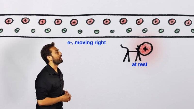

Why doesn't the positive test charge (cat, here) experience an attraction to the wire if the electrons are getting length contracted?
Because the wire is electrically neutral in that frame.
You are under the mistaken impression that the spacing between the electrons is fixed, like the protons. It is not. If you want to pack the electrons in closely you can simply charge the wire to a strongly negative voltage. If you want to spread them apart you charge it to a positive voltage. If you ground it then they will be spaced the same as the protons in the wires frame.
Length contraction happens, but is not relevant to the spacing in the wires frame. That spacing is set by the circuit. The spacing in other frames is then determined by the Lorentz transform from the spacing set by the circuit.
It isn't the particles that matter here, it's their spacing. By the way the problem is set up, the spacing of the electrons and the spacing of the protons are the same in the wire frame; thus it is not charged because there the number densities of the particles are equal.
Viewed in the electron rest frame, however, the electrons are now stationary so their spacing is larger because length contraction is no longer a factor. The protons, on the other hand, are now noving so length contraction means that they are closer together. Hence there is a net positive charge.
Stating all that the other way around, the wire is positively charged in the electron rest frame. When we switch to the wire frame length contraction means that the electrons are closer together and the protons are further apart, and the wire is neutral.

I already gave a full explanation of the scenario in post #7.

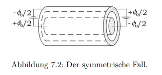

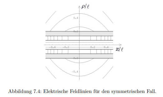

I think the problem is to consider just a single wire. To get a unique solution one must have a complete closed circuit. I think thus one has to solve the full problem of a coaxial cable. The infinite length makes it also somewhat critical, but at least one gets a formal solution, which seems to describe the problem for a finite wire not too close to the "ends".
I'll completely rewrite my manuscript within the next few days. I think now one should just solve the boundary-value problem with the correct relativistic equations for Ohm's Law.
A coaxial cable would be part of a completely different scenario. I think the best would be to consider a current loop, as described by @pervect in posting #27.
  • #31

I have now done the calculation and also typed it. To treat the complete coaxial cable, i.e., having a conductor for a full look solves all problems. One does not need to impose any artificial surface charges to get global charge neutrality but only the usual continuity arguments on the electric an magnetic fields at the boundaries of the conductors. Thanks to @Dale for pointing out the mistake in the earlier manuscript, where I imposed a boundary condition for the single cylindrical wire, which obviously is wrong due to the unphysical idea to describe a single current-conducting wire without taking into account that one needs a back current too. As demonstrated in the new manuscript, just solving the entire DC circuit problem in the rest frame of the wire leads to the correct charge neutrality (assuming an ideal voltage source). Maybe it's worthwhile to send this as a manuscript to AJP. What do you think?
https://itp.uni-frankfurt.de/~hees/pf-faq/relativistic-dc.pdf
As others explained, the distances between the electrons in the wire frame don't change when the current starts flowing, because unlike the positive ions, the electrons are not forced to keep constant proper distances. So the electron density in the wire frame doesn't change when the current starts flowing.
Here is a good explanation and diagram by @DrGreg :
https://www.physicsforums.com/threads/explanation-of-em-fields-using-sr.714635/post-4528480
This has been asked many times:
https://www.physicsforums.com/threads/electric-currents-and-length-contraction.930943/#post-5877453
https://www.physicsforums.com/threa...tion-of-electromagnetism.982883/#post-6284262
https://www.physicsforums.com/threa...magnetism-with-relativity.932270/post-5886984
Likes PeroK and Sagittarius A-Star

From the same author A.K.T. Assis exists also the following German book.
See on page 94, chapter 6.4 "Radialer Halleffect" and on page 105, chapter 7 "Koaxialkabel":
https://www.ifi.unicamp.br/~assis/Kraft.pdf
via:
https://www.ifi.unicamp.br/~assis/books.htm
Electrical field lines in the symmetrical case, according to the book:
Also, A.K.T. Assis mentions on page 8 of this book a here not yet discussed force of a wire on a charged test-particle at rest in the rest frame of the wire:
Das heißt, die externe Punktladung q induziert eine Verteilung von Ladungen längs der Oberfläche des Leiters und ergibt insgesamt eine elektrostatische Anziehung zwischen Leiter und q.
Google-translate:
That is, the external point charge q induces a distribution of charges along the surface of the conductor and results in an overall electrostatic attraction between the conductor and q.
From the publisher of this book, Apeiron, one can find also many dubious anti-SR books. However, that does not automatically mean, that every book of them is dubious.
