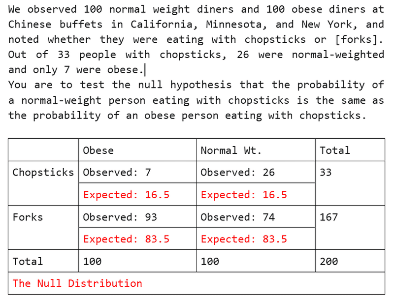

TL;DR Summary
Chi-Square Test
##H_0##: The probability of an obese person using chopsticks = the probability of a normal-weight person using chopsticks
##H_a##: The probability of an obese person using chopsticks ##\ne## the probability of a normal-weight person using chopsticks
"Partial" Chi-Square Test: I focused only on row 1 (Chopsticks) and computed the ##\chi ^2 = \frac{(7 - 16.5)^2}{16.5} + \frac{(26 - 16.5)^2}{16.5} = 10.9##
Degree of Freedom DF = Number of components - 1 = 2 - 1 = 1
The associated P-value < 0.005.
Significance level, ##\alpha = 0.05##
We can reject ##H_0##
1. The probability of an obese person using chopsticks ##\ne## the probability of a normal-weight person using chopsticks (from our P-value to ##\alpha## comparison)
2. The probability of an obese person using chopsticks < the probability of a normal-weight person using chopsticks. From the fact that the observed probability of an obese person using chopsticks (7/100) < the observed probability of a normal-weight person using chopsticks (26/100)
Have I got it right? Are there any errors?
Yes, this is how it would be used. However, there is a bit of a correction. In statement 1 you are accepting the alternative hypothesis. This test does not do that, it only allows you to reject the null hypothesis. So you can only technically say something convoluted like "This data does not provide evidence that the probability is the same" (rejecting the null hypothesis).
In practice, however, what you say is exactly how most scientists would report this work in most journals.
Similarly, in statement 2 you are neither discussing the null hypothesis nor the alternative hypothesis. This is a 3rd hypothesis.
Again, in practice what you say is what scientists would say also, even though it is technically not allowed by the tests.
