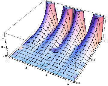

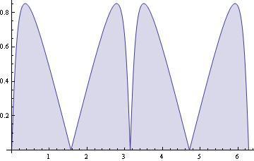

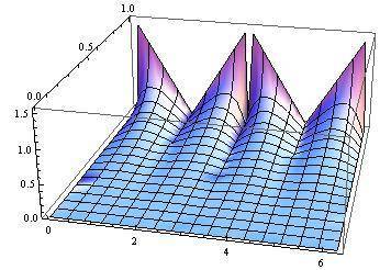

For the effect of a general boost on a general space vector, I get:
[tex]\textbf{r}'=\textbf{r}-\frac{\textbf{r}\cdot \pmb{\beta}}{\beta^2}\pmb{\beta}\left ( 1-\frac{1}{\gamma(\beta)} \right )[/tex]
And for the angle,
[tex]\cos(\textbf{r},\textbf{r}')=\frac{r^2 \beta^2-(\textbf{r}\cdot \pmb{\beta})^2}{r\beta^2\sqrt{r^2-(\textbf{r}\cdot \pmb{\beta})^2}} \left ( 1-\frac{1}{\gamma(\beta)} \right )[/tex]
[tex]=\frac{1-\cos^2(\textbf{r},\pmb{\beta})}{1-\beta^2 \cos(\textbf{r},\pmb{\beta})}[/tex]
where, for example, [itex]\cos(\textbf{r},\textbf{r}')[/itex] is the angle between the original space vector [itex]\textbf{r}[/itex] and its boosted counterpart [itex]\textbf{r}'[/itex].
