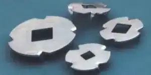

  2. Should I get some of these a] in addition?, b] instead?
Yep, this may work. Alternatively, you may look up 'fanged bolt'.

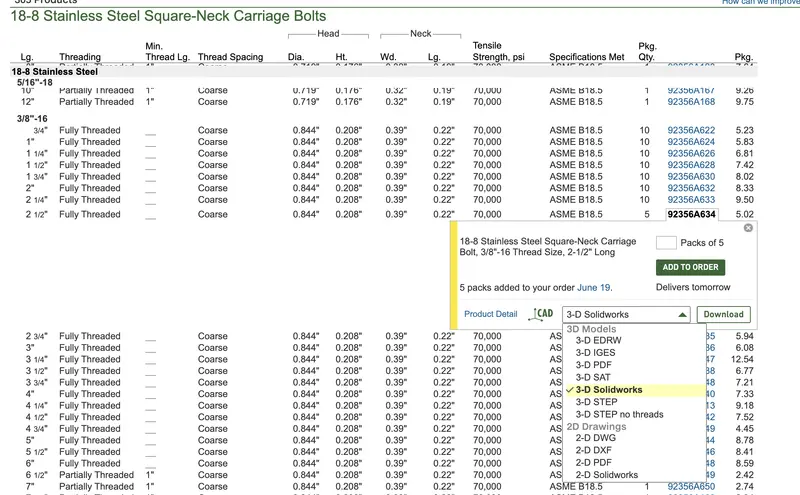

jrmichler said:
McMaster-Carr has everything, including 316SS carriage bolts: https://www.mcmaster.com/products/b...6-stainless-steel-square-neck-carriage-bolts/. Price $10.51 USD per pack of 5.
Thanks. This is the kind of thing I am leary of ordering online because I don't really know what I'm going to get if I can't see it and touch it.
For example, if I simply want to order some standard carriage bolts, why is it asking me to pick ... whatever that dropdown is.
What am I getting? "Models"? Wait, can I buy 2-dimensional carriage bolts?? Do they come in an envelope instead of a box? Can I assume shipping weight is "zero"?
I know those are CAD formats. What I don't know is why I am picking them while in the midst of ordering the real thing.
I thought for a minute that it was going to 3-D print my parts for me, and I got to choose what file format the print file would be.
OK, I see. A CAD diagram is a way of checking the product's physical specs that's better than a photo.
Wild ride, this.
The local hardware store only has 1/4" stainless carriage bolts up to 4" long, and I needed some 4.5" long. I ordered them from McMaster-Carr last night (Saturday), and got an email with tracking number this morning that they were shipped with expected delivery Tuesday.
Designers working with SolidWorks software really like McMaster-Carr. Click on that Download button, and the exact part is loaded directly into the assembly.
