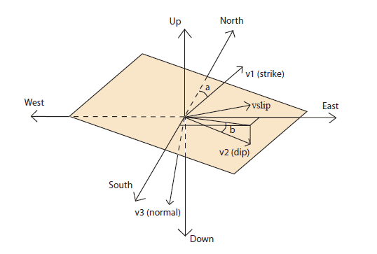

Hi. I have a huge problem and without solving it I can't move forward. I will appreciate any help.
Having the stress tensor S:
163.666557052527 -63.0272557558942 0.000000000000000E+000
-63.0272557558942 70.3802282767392 0.000000000000000E+000
0.00000000000000 0.00000000000000 0.000000000000000E+000
σ11 - North, σ22 - East, σ33 - Down
I have to calculate the normal stress and shear stress in slip direction for this focal mechanism
α - strike = 315°, β - dip = 73°, and λ - rake(slip) = 55°.
I think I know how to calculate the normal stress but I have no idea how to compute the shear stress in slip direction (55°)
Please help!
M.

Thanks very much for your reply. I really appreciate that.
I understand everything what you've just put there. the only one thing I can't get is when should I use the rake angle to calculate stress in dip direction?
I know I should use these direction cosines for the normal to the plane :
n=
| cos(strike)*sin(dip) |
| -sin(strike)*sin(dip) |
| cos(dip) |
The using my initial vector:
and n I can calculate the traction vector on that plane, and from that the normal to the plane (following your equation). However, using your shear stress equation, I will only get the shear stress in dip direction. Could you please help me resolve it in the slip direction? Any help will be hugely appreciated>
Thanks in advance

Hi Chat,
Thanks for your reply.
The slip is the direction in which the dislocation moves, usually measured from the direction of the strike (I attached two images). And what I need to do is to resolved the traction vector into its shear component in this particular shear direction within the plane.
Thanks a lot for your help
sthoriginal said:
Hi Chat,
I'm not sure. If I had to guess, what I would do would be to dot the shear stress vector with a unit vector in the slip direction.
