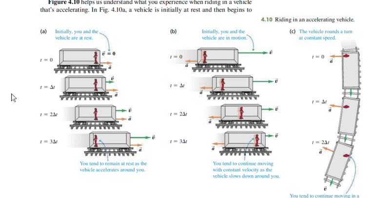

I read it from the book but I don't understand when we combine (a) and (b) it seem like the man gain velocity.
Clockclocle said:
I read it from the book but I don't understand when we combine (a) and (b) it seem like the man gain velocity.View attachment 315611
You should have posted that in your original post. That's not what traveling in a car is like. You have seats that push you forward with the car. That's more like being on roller skates in an empty freight car.
You can do this experiment if you have a marble and a biscuit tin. Put the tin on a flat table and the marble in the middle of the (clean, empty) tin and make sure it doesn't roll on its own (i.e. that the bottom of the tin is flat, not curved). Without lifting the tin at all, slide it sharply (i.e. quickly and with rapid changes of direction) backwards and forwards on the table.
Ideally, the marble will stay in one place relative to the table (a piece of tape on the table to mark the initial location of the marble will help). In practice there is some friction, so it will actually start to move in the same direction as the tin, but if you move the tin reasonably sharply and take care to only slide the tin you will find that the marble moves much less than the tin. A video camera so that you can freeze frame and see how far you are moving the tin and how far the marble is moving may help.
As PeroK says, this is a very different experience from traveling in a car. In that case you have chairs and seat belts specifically designed to stop you from sliding around relative to the car, even under the high accelerations you may encounter in the event of a crash.
Sorry for wrong question. Actually I don't understand the picture. When the vehicle accelerate to some large velocity (picture A) then immediately decrease the acceleration why the person change from stay at rest to continue moving ?
Because they hit the back wall of the freight car?
a) and b) look like two different, unrelated scenarios. They are not different phases of the same motion.
Likes topsquark
So the hit give him velocity ?
There was a thread recently where I said I didn't like physics being taught with "unrealistic" scenarios. I think your book is the sort of thing I was talking about. If you are standing on a stationary bus and the bus accelerates, then either you get pulled forward by the bus (through friction on your feet or by holding on to something); or, if there is nothing to hold onto and the bus accelerates too quickly, your feet get pulled out from under you and you fall over backwards. What you don't do is remain at rest relative to the ground outside and slide to the back of the bus. An empty drinks bottle lying on the floor might do that, to some extent.
So, the physics presented in your book seems unrealistic to me. Newton's first law, in terrestrial scenarios, is actually quite hard to see (which is why it evaded the Greeks and the Romans and it took the genius of Isaac Newton to identify it).
The author of that book seems to be pretending that Newton's first law can be seen easily on Earth. Which is simply not true. Even in the example @Ibix gave of a marble in a tin, the marble does not remain at rest relative to the table, as there is inevitably a friction force between the marble and the tin (even if this force is quite small).
The best example of Newton's first law is something like the Voyager spacecraft , that continues through empty space at an almost constant velocity almost indefinitely, where it is not slowed down by the external forces that are inevitable here on Earth.
The man in a did not gain velocity to become the man in b. They are diffent scenarios and different men.
Yes, the man in a could have been struck by the rear wall of the railroad car after the final frame. He could have been accelerated thereby, thus gaining velocity. He could then be in the position of the man in b.
