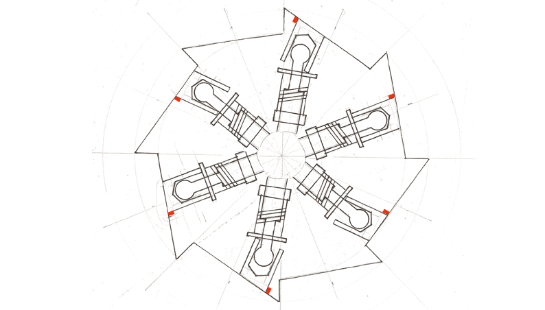

Hi,
I want to share my thought on what I have called a 'subducing head',
it's a pneumatic engine.
Here's the first drawing==>
The concept is to apply more pressure on one side of a shape within an air compression chamber.
So the red squares are areas of pressure, which don't occur on the other side of the shape,
as the steps mating(wrung) allow the backward pressure face to be culled. Their area in practice ceases to exist.
However this does mean that the feet have to move uphill, and the air pressure will jam them outward,
meaning that inclination has to be overcome.
Would this provide circular movement?

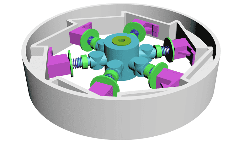

Here's a 3d model:-

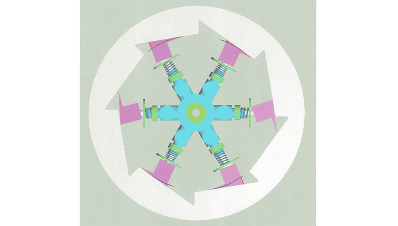

...and the forward pressure areas of such:-
I would like to share, and get this built. Do you think it would work?

Welcome to PF.
No, it will not work.
The mechanical power produced by a pneumatic motor cannot exceed the product of the pressure difference by the volume of airflow.
Where is the air inlet, and where is the air exhaust?
There can be no flow. It will settle in one position.
Likes russ_watters and berkeman

there is no exhaust, the inlet is a push fitting in the sealed outer plate(which isn't shown)
the conjecture is that there is more area on one side of the feet,
allowing a not infinitesimal pressure(either) to exist
the backwards face of the feet is flat to the outer case, so they do not catch the usually equal compression
they are pushed, I put contentiously, but can they climb while they are jammed into the outer?
There are principles, such as conservation of energy, that must be obeyed in engineering. You have designed something so complex that you cannot understand how it works all at one time. By focusing on a small difference in area, you have neglected the supply of energy from the through-flow of air. The steepness of the ramp will exactly balance the difference in the small areas. Air will leak between the ramp and the slider, so the slider will actually have a balanced area of equal pressure air. If you turn it by hand, it will make a noise, you must provide that noise energy by hand.
There can be no airflow through the device. Where does the energy come from, that must overcome the sliding friction? It appears you have designed a "perpetual motion machine", something that we do not discuss on this forum.
Likes Ranger Mike, russ_watters and Greg Bernhardt
