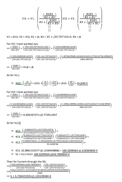

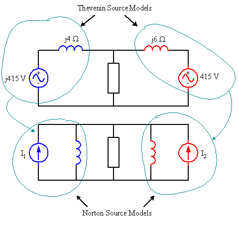

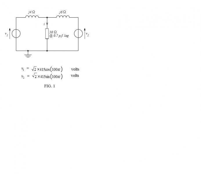

FIGURE 1 shows a 50 Ω load being fed from two voltage sources via their associated reactances. Determine the current i flowing in the load by:
Superposition Theorem
[/B]

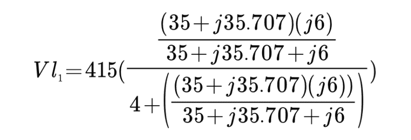

:[/B]see attached files as I can not write in itex and its too complicated to try and write it using ()()().
Problem is that once I have calculated both Vl1 and Vl2 and I calculate he current I for each and add the currents together my answer for current is different to what it should be by quite a lot! am I doing something wrong here? I have also tried a different method where by I remove each voltage source the work out I1, I2, I3 for Voltage source V1 and I4, I5 and I6 for voltage source V2 in turn adding or deducting them as required and my answer still isn't what its supposed to be. The reason I know what the answer should be is due to the fact that the first part of this question asks me to calculate it using Thevenins Theorem...
