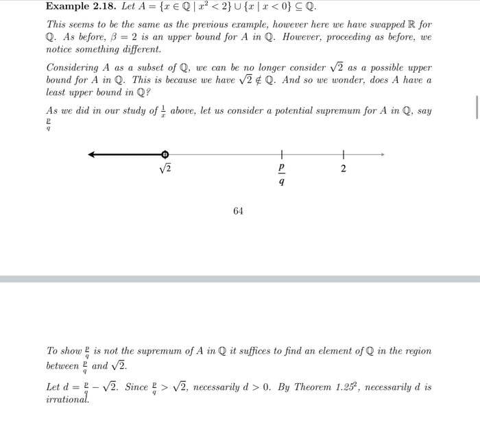

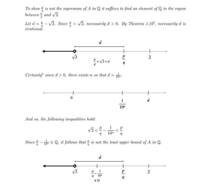

Sorry for the late reply. I was looking through my universitys notes and this is what they did, although it’s kind of a different example. Is this kind of similar to what I did?

The proof is much easier if you have developed the real numbers and can use the properties of real numbers. That's what these notes have done. That is not a proof from first principles. If you just developed the rationals from the naturals, then you don't have the power of real analysis at your disposal. And irrational numbers, such as ##\sqrt 2## simply do not exist within the mathematics you have so far developed.
In the PF thread you originally quoted, the student has a proof that relies only on the properties of rational numbers. That proof is not perfect, but it is a good attempt at a proof from first principles.
properties of the rational numbers as in the distance d is irrational? (They used the fact that the difference between a rational and an irrational number is also irrational?) So does first principle refer to only using properties of the rational numbers?
I had a read over your proof for this problem, I'm a bit confused to as what's happening. I understand the algebra but I don't know whats the logic behind it
Yes. There are maths courses where this is the idea. To develop the rational numbers first and then develop the real numbers.

I'm fine with the proof from the notes, its just that since you said it wasn't from first principles I was just wondering on how your proof, which comes from first principle works.

I also did some reading on Cartesian product, relations, total order and partial order.
So a Cartesian product AxB is just ordered pair (a,b) where a is an element of A and b is an element of B right.
And a relation is just a subset of the Cartesian product.
Now total and partial orders.
Total order is denoted by < and partial order is denoted by <=? I’m a bit unsure about these, please correct me if I’m wrong.
And a total order relation requires four things:
Reflexive, anti-symmetric, transitive and comparability? I’m a bit unsure what comparability is though.
And for partial order relation I think it just needs to be reflexive, anti-symmetric and transitive?
The product ## A \times B## is not a pair ##(a,b)## but rather the collection of _all_ pairs ##(a,b)## for ##a \in A, b\in B##.
