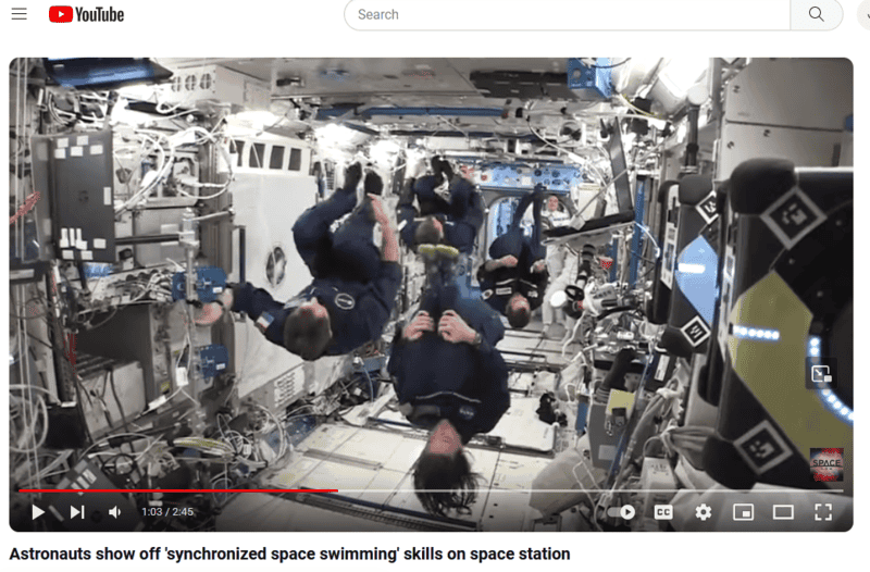

Let's imagine a space tourism program where there is a fun part, the tourist can wander freely in space with a jetpack.
Let's assume I stray randomly in space, floating leisurely in zero gravity. Then I detach my jetpack, just the time to make a selfie. While fiddling with the phone to setup the camera, I forgot to hold the jetpack which then drifts slowly, roughly 50 meters away from me.
Alone in space and far from the group. The jetpack is the only way to get back to the space station. Is it possible that I swim in space to catch up with the jetpack? The swim stroke I think of is a kind of half-breast stroke. The legs stay immobile, only extend the arms quickly in front (towards the jetpack I suppose). Then slowly bring back the hands under the chin, and repeat again the quick arm extension. Swimming my way to the jetpack.
It is possible to create propulsion by self-generating momentum with own limbs? In case it is possible, what would be the most efficient way to "swim" in space?
