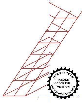

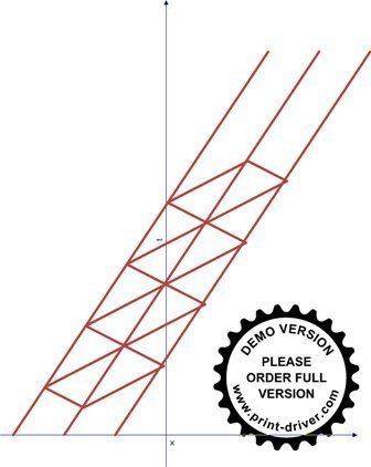

Aha! I think there's a terminology mismatch going on here. Synchronised might mean that zero on one corresponds with zero on the other, or it might mean they're going at the same speed. That's two different things.
We can all just define zero of time and space (origin) as the place and time where/when the middle of the train passes through the middle of the station. If we'd been writing down numbers before the train arrived on a different basis, we can all just note when in our old sync the origin happened and correct our notes afterwards. This is not the problem.
The problem is how fast the clocks run and how long the sticks are. It's not sensible to neglect length contraction compared to time dilation or vice versa because they both happen to the same degree, namely, gamma.
So let's just assume we can define the origin clearly. We can because there are no distances to worry about. We put a big red spot on the middle of the train and the middle of the platform, and when they coincide, that's everybody's origin of time and space. Sorted.
Now let's get started with the real problem. We don't know how to synchronise clocks that are not at the origin. We can't carry them to the origin, sync them there and carry them elsewhere because WE DONT HAVE AN AXIOM to tell us what happens when we move clocks around. In fact, the only axiom we have that might come in useful here is the one about the constancy of c. We can use that as follows: at time t1, launch a light ray from the origin to the remote clock and back. See it arrive back at t2. Set the remote clock to (t1+t2)/2. Because of the axiom, we can even do that on the train. That's the only method we have that's guaranteed by the axioms.
Now you can draw the rhombus diagram to show that the guy on the platform will think that the guy on the train screwed up. You draw the train as a world line at about 1 o'clock, and the light lines at 45 degrees. You see that the light beam reaches the front clock late because the clock is running away from the beam. So the guy on the platform thinks that readings on the front clock underestimate the actual time.
Now imagine that the guy on the train wants to measure the platform. Assume that both train and platform are 100m long at rest. He'll put cameras at the front and the back of the train and tell them to go off at t=0. What happens? Options:
* both cameras see the exact end of the platform
* both cameras see green fields
* both cameras see platform with no end in sight
* one camera sees fields while the other sees platform.
Figure it out for yourself. The correct answer is that both cameras see green fields and conclude that the platform is shorter than the train. Now we reverse the whole argument and see that the platform also thinks the train is too short.
We now have three out of four pieces of the puzzle in place:
1) Obviously, the time axis of the train looks wonky from the point of view of the platform. That's just because the train defines his own centre of x as the centre of the train, which the platform can see is moving.
2) We've also established that the space axis of the train is wonky, that's the bad sync of the front and back clocks.
3) We see lorentz contraction resulting from the bad sync of the clocks.
To complete the square, we'd like to see time dilation resulting from the disagreement about the centre of x. I'll leave that for homework ;-)
