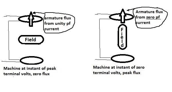

In purely resistive case, I read that the armature reaction is only distorting. How does that demagnetize the field due to the poles and produce "armature reaction drop"? If there's a capacitive load, armature amp turns are added to the field amp turns,raising the terminal voltage.
the secret lies in phasor diagrams, perhaps.
This sketch from link referenced earlier showed physically why mmf from reactive armature amps add directly to(or subtract from) field 's mmf
here's another old thread that's related.
https://www.physicsforums.com/threads/ac-generator-on-grid-governor-and-amp.759387/#post-4785338
Unfortunately most of the images have disappeared, though. Gone with the e-wind?
This one survived...
armature mmf phasor is just the green one painted black and slid up there, preserving length and direction.
In your mind rotate green armature amps to any pf you like
near unity field mmf and armature mmf are perpendicular so effect of armature reaction doesn't change magnitude of total mmf very much, only shifts phase. Hence term "Distorting" used by some authors
near zero pf the mmf's add directly, try it by rotating green arrow straight up or down... remember armature mmf follows

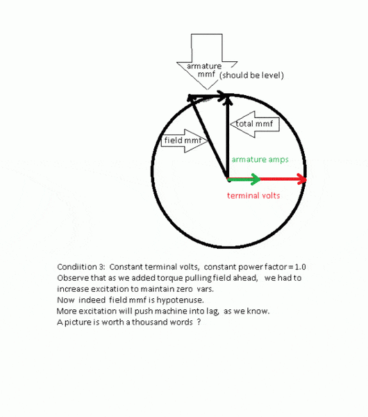

If I rotated the green arrow so as to get unity pf, total mmf vector should be the hypotenuse, with other two sides as field mmf vector and armature mmf vector. But if the field is constant (radius of the circle), how could I get total mmf vector as the hypotenuse? Its the field mmf that becomes the hypotenuse in that case and not the total mmf.. I don't know what I am missing...

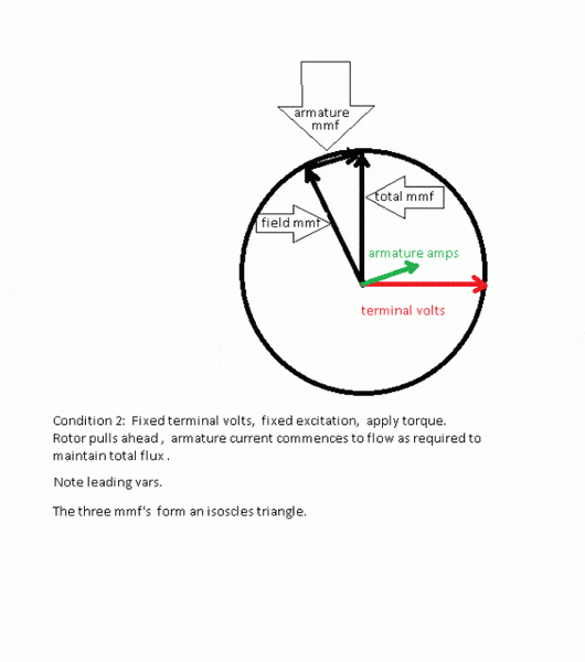

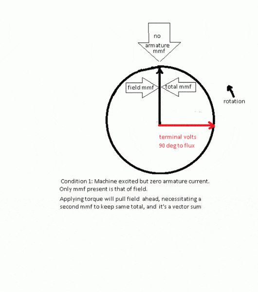

hmm i found those missing images
unity power factor, zero load
same excitation but load applied by increasing torque supplied to shaft
^^note this is with machine connected to grid so terminal volts are constant . As anorlunda says, that's how it's usually taught ,so it's become intuitive to us ..^^
this is fixed terminal volts, same power as 2, but excitation tweaked to restore pf to unity.
Your stipulated condition, constant load, means power factor is fixed which means the angles don't change just the lengths of the sides
so changing excitation changes only voltage (the diameter of your circle) and armature current
caveat: assuming that by "constant load" you mean "some fixed impedance" and not "some fixed KVA"
because if you lock both KVA and excitation then you've fixed two sides and an angle of the triangle so nothing is free to change.
Fire up Paint and draw yourself some circles ?

Wait! Constant-Increase-Decrease-grid caused-machine caused-field caused; that is a wrong way to think about things, and those are the wrong questions to ask.
You should be using the equivalent circuit for a synchronous machine linked in #11. The circuit tells you how things behave, just as in any circuit.
Is the mathematical approach a problem for your students?

cnh1995 said:
For constant load and variable excitation, how does the power factor change? Icosø remains the same but both I and cosø change with excitation.
there's your trouble. Which angle do you mean by ø ?
Angle between terminal volts and amps doesn't change with excitation, for power factor is determined by your load.
Angle between rotor position and terminal volts does change with excitation, for excitation affects the strength of the magnetic field that's coupling energy from the rotor into the stator windings.
Teacher should have you observe and plot that with a stroboscope, it's really fun to watch the machine respond.
Angle between terminal volts zero crossing and rotor position is called "power angle"
and it's same as angle between field mmf and total mmf
y.php?image=http%3A%2F%2Fi232.photobucket.com%2Falbums%2Fee289%2Foldjimh%2Fugenetic3_zps0b47bca3.gif
observe if you increase field mmf by raising excitation, everything grows in proportion
armature amps stay in phase with terminal volts, and increase,
terminal volts increase as they must to drive more current through lamps,
but power angle stays about the same unlike when providing constant mw to infinite bus...
Could it be you've confused "power factor angle" with "power angle"?
Learn to work that simple one-turn machine from post 9 in your head. It makes lot of formulas intuitive and will help you with D-Q as mentioned by Anorlunda. D-Q is the coin of the realm, you'll need to be fluent in it, so start now building mental models to facilitate becoming fluent with the math.
