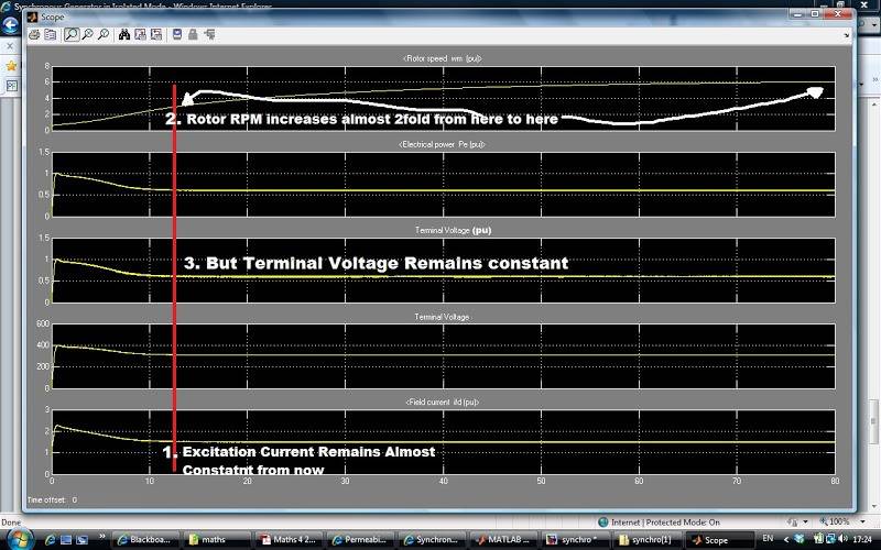

I tried simulating a simple synchronous generator driving a resistive load in isolated mode (not connected to the grid/infinite bus), using Matlab Simulink, SimPowerSystems.
First I used, Input mechanical power of 1 pu, and output resistive Load of 1 Pu. And Excitation Field Voltage of 4 pu. This resulted on output terminal Voltage of 1 pu, Output Electrical Power of 1 pu, and,
and Rotor Speed of around 0.5 pu.
I then Increased the excitation voltage to around 6 pu and everything remaining same, the rotor speed drooped to 0.3 pu.
All this seems logical, in that, when I am over exciting, this result in higher Pole fields. In order to maintain same terminal voltage, the rotor speed must decrease.
Same terminal voltage needs to be maintained, because, since the load I used was resistive load, only by maintaining fixed terminal voltage, can the electrical output power equal the fixed input mechanical power.
As we know, the two powers (input mechanical power and output electrical power) must always equal, their difference creates an accelerating torque that restores the rotor to correct speed.
I hope everything I said is correct?
I will ask my question once I get the confirmation that I was correct.
Thanks.
Ok, I will ask my question right off.
Is there any chance, the RPM of synchronous Generator to keep on increasing and increasing, when its connected to a fixed resistive load and the excitation voltage is fixed.
Ok, at the begining, the applied mechanical power is greater than the ouput electrical power, but when its speed keeps increasing, so would its generated voltage. I think, at one point, the voltage would be large enough that the power consumed by the resistive load would be big enough to counter balance the applied mechanical power.
But this don't seem to happen in my simulation. When I set the excitation voltage at around 1 pu, The speed just keeps increasing on and on but somehow, the terminal voltage remains fixed. Although I have fixed excitation voltage, I guess the terminal voltage should keep increasing with speed??
This seems so simple, but yet Matlab simulation is against me. Just want to hear your views?

sorry, but I think at the final steady state condition, the voltage must be 100%, because, only then the output power will be 100% again. (to balance the constant (100%) input power).
i think you're right. my bad, i was in a hurry (grandkids calling) and i didnt think it through.
okay - you've got that part nailed. GOOD!
we could write some simple simultaneous equations
power proportional to volts^2
volts proportional to speed X excitation
power1 = k X (speed1 X excitation1)^2
power2 = k X (speed2 X excitation2)^2
your condition that power1 = power2
lets us divide those first 2 equations and get
1= [(speed1 X excitation1) / (speed2 X excitation2)]^2
since excitation2 = excitation1 X 1.2 , what is speed2/speed1?
neglecting internal losses and magnetic nonlinearity of iron , of course
please check my thinking, as you did before,
and you don't have to be be so polite when calling out my mistakes...
thanks for your kindness..

Hi,
I have highlighted my concern below,
Please have a look,
Although, I agree that the voltage across resistive load is proportional to current through it, But in our case above, when the speed is increasing, what might be preventing the terminal voltage (and load current) to increase ?

I_am_learning said:
Hi,
Please have a look,
What happens to the frequency of the generated waveform when RPM soars? Yes, I know frequency should rise in step with RPM, but what does MATLAB show?
I couldn't find any method for direct frequency measurement. But I could trace the instantaneous terminal voltage. Calculating from the time period of sinusoidal voltage waveform, Yes, the frequency was in step with RPM.
I have not looked at your model, but from the scope plots it looks like your running in "phasor mode" ( in your powergui) ?
To my knowledge the Phasor simulation mode solves the algebraic equations describing the system, not the differential equations. That is, your 'w' (omega, fundamental frequency) is constant. Then (i think) the equations for your machine will not give "correct" answer you are looking for. The terminal voltage (or more correct, the emf) at constant excitation will be governed by E=k*jw*phi where w is constant at 50 or 60 Hz set in your powergui.
I don't know the scope of your simulation, but it seems like you would like the machine to operate at variable frequency, like in reality. Then you probably want to run in "continuous simulation mode". Remember to convert the measuring signals from instantaneous to RMS.
In the real world an synchronus generator will have two controls a speed control that keeps the machine at constant speed (by controling the amount of fuel entering the prime mover) and a voltage control that keeps the line terminals at a constant voltage (by altering the excitation current). The two controls are independent of each other.

Hi,
The powergui block is set at continuous mode. And, as I previously told, from the instantaneous Voltage waveform, it can be actually confirmed that the frequency is increasing with the RPM. So, no, w doesn't seem to be constant at 50 Hz.
Perhaps, you can spot something, please have a look at the model.
Thanks.
hi again iaml
I agree that the voltage is doubling however, have you considered that this is a step response.that said MATLAB will put this step on to anything you want however, what you will see is the step response in time. Can you let me know what declimatiion your simulation is running at, as it appears you are running over 80 seconds 8 seconds 0.8 seconds ect ?
I quickly ran your simulation over one second and applied your constant value of 0.5 ? (base unit ?) your voltage stabilises after 0.5 seconds which is a direct result of shaft speed and attached load. I then ran the simulation for 20 seconds, if you look at the stator current as it produces its rotating field this tends to reduce the field from the excitation winding. This will reduce the excitation voltage by an amount Ear. Ear is most easily modeled as the voltage drop across an inductive reactance Xar. let me know the answers for above and i will take another look. be carefull in your defined model selection, this is a synchronous machine. as you know these machines can operate as motors or generators depending. your model and graphs attached are running at your own values so it might be a under/over driven problem. On quick opinion I can't see much wrong with this generator set up, I have seen far worse simulations !
attach the graph below
Red = field current
Green = rotor rpm
Blue = terminal voltage
  • synchronous generator.fig.doc
aha
Xar indeed cause "armature reaction" and is basis of synchronous impedance.
for a purely resistive load it sholdn't be much of an effect ( for reasonable amount of Xar ) since the vectors are at 90deg.
does Matlab let you set such parameters?
if so, what is your Xar?
we had a 894mva machine with 171% which the old-timers considered high.
hope you don't mind me peeking over your shoulder.
this simulation you guys use today is amazing to me,
maybe i'll learn something.
old jim
no problem Jim
glad to be of assistance to any likeminded individual !
I’ve included the graph of your query on Xar, and also the schematic of the Matlab Simulink
there is enough to cause the gremilins Iaml is having, the graph I included is zoomed right in on start up to give you an idea only. max vars can be read off the schematic If you notice this puppy pulls >2000 amps per phase, would never have guessed just by ratings (50 hz 400v 2000 kva) 2 mega watt !, this machine is being driven out of synchronisation some how but its not obivous to me at the moment, not yet that is !
all the best
  • max vars.doc
i confuse easily so don't be offended.
in graph field current speed and terminal volts all go up
red green and blue
if this thing is islanded with constant power in (pm?) shouldn't something go down?
ahhh, i see you're starting from initial condition at rest? everything zero?
simulation needs to run long enough to establish steady state, THEN apply IML's change to field ?
i had similar experience when i was simulating on my TI99 in mid 80's
bear with me i'll catch on.
old jim
