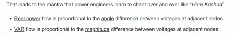

Re read this PF Insights Article.
https://www.physicsforums.com/insights/ac-power-analysis-part-2-network-analysis/
ffp said:
I also know that what determines real power output is the speed and torque of the axis of the generator.
No. Not speed and torque, but angle. Then ask yourself, how is angle related to speed?

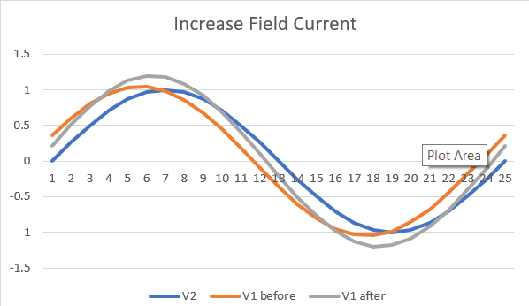

So, when you increase field current, the primary result is to increase the magnitude at the generator terminals which is V1. That doesn't tell us what happens to the phase angle of V1. So how does that change the real and imaginary powers, P and Q?
##P=\frac{V1•V2}{X} \sin{\theta}##
##Q=\frac{V1(V1-V2)}{X}\cos{\theta}##
where ##\theta## is the phase angle difference between V1 and V2.
Now, let's increase field voltage which caused the voltage V1 to increase. As you can see, both P and Q increase with V1 increasing. However, since P is constrained to be equal to Pmechanical the angle ##\theta## must also change to keep P constant. That is the part missing in your thinking, voltage has a magnitude in volts that you can measure with a voltmeter, but it also has a phase angle that is critically important. If you had an oscilloscope instead of a voltmeter, you could see the whole story.
You would see that after the field voltage increase, V1 increased in magnitude, but it also changed phase to become closer to the phase of V2.
Here's the moral of the story: In AC analysis, you can't discuss voltages or currents without including the phase angles of both. Unfortunately, phase angles can't be seen on voltmeters or ammeters.
Likes berkeman

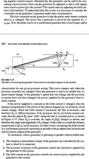

A change in the field current changes the rotor angle w.r.t. the angle of the terminal voltage. The magnitude and phase angle of the terminal voltage are fixed (by the grid).
You must have seen the phasor diagram of this scenario in your notes/textbook.
Consider the following two cases:
1) The generator is supplying active power P1 to the grid, and prime mover torque is increased:
Increased torque tends to increase the angle between E and V, and after a transient, the generator rotor settles down at a greater power angle such that P2=EVsinδnew/Xs is greater than P1.
The terminal voltage remains constant (as it is established by the grid).
2) The generator is supplying active power P1 to the grid, and its field excitation is increased:
An increase in the field excitation increases the electromagnetic torque on the rotor. As the primer mover torque is unchanged, the increased EM torque tends to decelerate the rotor. But since the generator speed is locked by the infinite bus (or the grid), the rotor settles down at a lower power angle such that Eoldsinδold=Enewsinδnew. Here, the active power supplied by the generator is unchanged (since the speed and prime mover torque are unchanged), but at a lower power angle.
When a generator is connected to the infinite bus:
1. Its terminal voltage (magnitude and phase angle) is constant (often denoted by V∠0°).
2. The frequency of the infinite bus is fixed. Hence, in steady state, the generator always rotates at the synchronous speed.
When excitation/prime mover torque is changed in the generator, the generator responds by changing its power angle which changes P and Q accordingly.
Hope this helps.

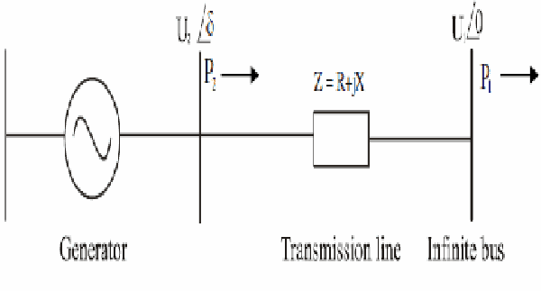

Ay ay ay. Although you are trying to be helpful, you mixed up the terminal bus with the infinite bus so badly that several of your statements (like the one above) are counter productive.
The OP question was about a synchronous generator connected to an infinite bus, as in the one line diagram below. It is the infinite bus voltage (U1 in the diagram) that is normally taken as 1∠0°. Since there is power flow, there must voltage drop across the transmission reactance Z. Therefore the terminal voltage (U2 in the diagram) can not be 1∠0°. Also, it's magnitude and phase must vary when power varies.
Same mistake. If terminal voltage and angle were constant, and infinite bus voltage and angle were constant, there could never be any change in the current or power sent from one to the other. (See U1 and U2 in the diagram above)
Same mistake. It is not the terminal bus, but rather the infinite bus denoted by V∠0°
I am trying to get @ffp to understand synchronous operation of a generator when connected to the grid. It can not be understood by thinking of the generator in isolation. The impedance Z in that diagram is just as much a part of the system as internals of the generator. A generator serving a local load is not interconnected and it is not synchronous with anything external. This case of a generator connected to an infinite bus through an impedance Z, is the simplest possible case of interconnected operation. That system can only be analyzed by simultaneous consideration of all the components including Z.
Edit: One more thing. Terminal voltage is not fixed by the grid. Quite the opposite. There is a voltage regulator at the power plant. It is a closed loop controller that varies excitation (field) voltage to hold terminal voltage at the set point. If terminal voltage was fixed by the grid, there would be no need for the voltage regulator.

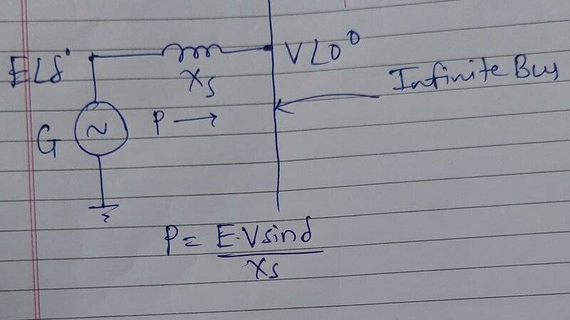

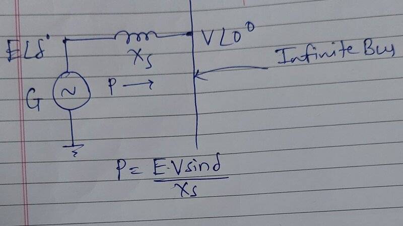

I was explaining this scenario.
The generator is connected to the infinite bus through its synchronous reactance alone. There is no transmission line. So the terminal voltage is same as the infinite bus voltage.
Likes anorlunda
That's better. But it is not what the OP in this thread asks about, so it is misleading to quote it here.
That E in your diagram is not physically accessible. It is like the voltage in a Thevenin's equivalent; a useful analogy but not anything real.

I'm sorry, but i couldn't find the answer.
To change the reactive power, the Ea (and thus Vt) have to be lagung or leading in relation to the voltage of the infinite bus, right?
Ea is equal to K(constructive constant) x Φ (flux) x ω (angular velocity if shaft).Since the If (field current) is DC, and is practically linear in relation to flux I don't know how it could change the angle of Ea.
The angle of Ea is determined by... ω?

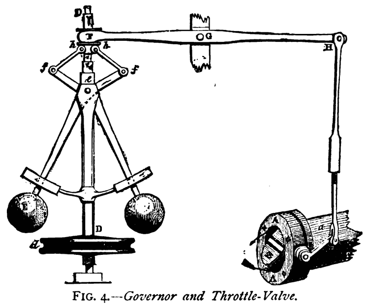

ffp said:
Ok, in this case Pin, which is equal to τ.ω (torque x angular velocity) is also increased by the change in If, since the torque is proportional to the fields of rotor and stator.
Wrong. Turbine torque is proportional to steam pressure and steam flow rate. You can't change it directly by doing stuff in the generator.
In addition, you just gave me a chance to use my favorite graphic.
That is the James Watt flyball governor. It was the classical way of adjusting the power of power plant generators for half a century. It was attached to the turbine, and the throttle controlled steam flow. So, if you do anything on the electric loads, the grid, or the generator that changes real power distribution, it eventually causes this governor (and every other governor in all the plants on the grid) to react.

This and my earlier post #16 are machine-centric.
I believe thinking simultaneously about the internal working of the generator (stator, rotor, fields etc) and changes on the grid (P, Q, phase angles ,voltages etc) would be confusing and counter-productive for you in the beginning.
You can upload the circuit diagram and relevant text from the book you are studying, and see if you can relate the answers in this thread to that.
Your confusion could be due differences in the nomenclature used here and that in the book.

Thanks for the torque explanation. I have forgoten that in generator mode, there is a torque opposing the rotation and it is proportional to the load, right?
About the book, it's Electric Machinery Fundamentals by Chapman. I stopped in this part:
I can understand the explanation using the phasor diagram, but not how it would work inside the machine. Also, why an generator operating alone have it's Vt changed by If, but when connected to an infinite bus, it doesn't?
EDIT: Also, the book says that a generator operating alone has the power dictated by the load. While connected with an infinite bus, the power is constant (hes considering ω unchanged). Wouldn't the power be ALWAYS according to τ and ω?
EDIT2: Curiosity question: it says that when connected to infinite bus, speed *cannot* change. It's physically impossible? What happens if you speed up the shaft (by letting more steam go, for example)? Would the oposing torque make that physically impossible, or that would just mess up electrical frequency and is not wanted (but possible)?
See the diagram attached in #19.
When analysing things from the machine side, the machine is assumed to be connected to an infinite bus. The voltage, phase angle and frequency of the infinte bus are fixed. It is an ideal bus whose voltage, frequency and phase angles cannot be changed by connecting/disconnecting a single generator. In practice, there are several systems and mechanisms in action that make the real-life grid "almost" an infinite bus.
This is the simplest model to analyse things from the generator side.
The E in the diagram (in #19) is the excitation emf and V is the terminal voltage of the generator, which is also the infinite bus voltage.
When the generator is operating in stand-alone mode, the infinite bus is replaced by an impedance and it is just like a normal ac circuit.
But when the generator is operating on the inifinte bus, its steady state speed, frequency and terminal voltage are locked by the infinite bus.
Before you connect the generator to the infinite bus (or "the grid" in real life), you must match generator's voltage, phase angle and frequency with the grid voltage, phase angle and frequency .
There must be another chapter in your book about how this synchronization is done in real life.

  • #31

  • #32
ffp said:
But that doesn't mean you can't change any of them after connecting. So, my Edit2 question remains. It is physically impossible to accelerate the prine mover after connecting to the grid (opposing torque makes it impossible, or something like that), or it isbpossible but it's something undesirable and always avoided because of some problems this could cause in the grid (like messingbwithvother generators connected)?
If you increase the steam input with the intention of running the generator faster, the rotor will accelerate momantarily, but the infinite bus will force it to resume the synchronous speed after a transient period of damped oscillations (which depends on many factors like machine inertia, damping arrangement etc).
cnh1995 said:
If the steam input is increased, the rotor would accelerate -- more "active" armature current will flow -- this will increase the electromagnetic torque and decelerate the rotor -- the rotor will oscillate about a new angle δ -- finally settle down at δ and resume synchronous speed.
The infinite bus locks the generator speed. Hence, when you increase/decrease the prime mover torque, the generator undergoes a transient of oscillations and settles down at an advanced angular position w.r.t the infinite bus voltage, and supplies the active power proportional to the product of T and w.
So to answer your question, yes it is impossible to increase the steady state speed and frequency of the generator connected to infinite bus. If you try, you will end up changing the active power output of the generator. The steady state speed and frequency will remain unchanged.
If you attempt to change the terminal voltage of the generator (which is same as the infinte bus voltage) by changing its field excitation, you will end up changing its reactive power output. The terminal voltage will remain unchanged.

My issue was with the notion that increasing If would change reactive power. That's not intuitive at all.
As I was studying induction motors and DC machines before, the increase in the magnetic flux always meant more active power: the stronger the flux, stronger the torque.
