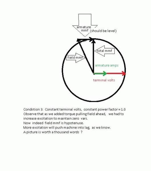

Hi @jim hardy..
I have a small question about this diagram..
Here, before raising the excitation, the VARs were leading and to bring them back to zero, excitation was increased. Right?
Before that, the rotor was given extra mechanical torque and hence, it pulled ahead. My question is, how does the rotor rotate at the previous speed? It accelerates while pulling ahead and hence, shouldn't its speed be more? Real part of the load current stabilizes the rotor and it moves with a constant speed after pulling ahead but shouldn't that speed be more than the no load speed?
I'm on a trip but will take a minute to answer.
How can it ?
You haven't thought that question through.
The speeds are unequal only while the rotor is changing its power angle.
It accelerates, gets ahead and decelerates. Probably it'll hunt a little as it finds new equilibrium power angle.
thought experiment......
What if you and i are both running side by side around a one mile circular track at 15mph, doing repeated 4 minute miles?(Unlikely for me at my age )
If you sprint a little faster to get a few feet ahead and then slow back down to resume 15mph,
we will both continue to do 4 minute miles with constant distance between us
and both at 15mph.
You do not need to run faster to stay that few feet ahead, nor can i run slower and stay same distance behind.
Yes. That's intuitive. Also, I forgot that the differential equation governing relation between power angle and time is of second order, which explains the oscillations of the rotor.
