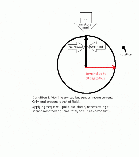

how is the back emf affected by the flux of the rotor?
I know the relation : Ea=k*phi*w
but i need a physical explanation
Three phase field windings produce a rotary traveling magnetic field.
The wound rotor has a magnetic field.
The two fields lock to maintain synchronous rotation.
Which back EMF are you referring to ?

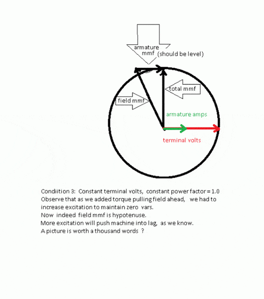

I made these drawings* some years ago for another thread that i can no longer find.
but you might find these two really old ones helpful
