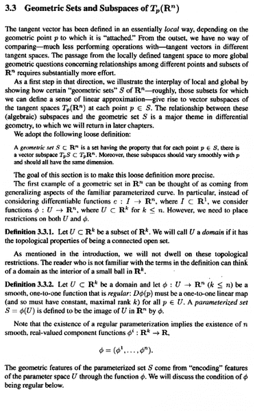

I am reading Andrew McInerney's book: First Steps in Differential Geometry: Riemannian, Contact, Symplectic ...
I am currently focussed on Chapter 3: Advanced Calculus ... and in particular I am studying Section 3.3 Geometric Sets and Subspaces of [itex]T_p ( \mathbb{R}^n )[/itex] ...
I need help with a basic aspect of Definition 3.3.5 ...

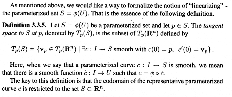

Definition 3.3.5 reads as follows:
In the above definition we find the following:
" ... ... Here, when we say that a parametrized curve [itex]c \ : \ I \longrightarrow S[/itex] is smooth, we mean that there is a smooth function [itex]\tilde{c} \ : \ I \longrightarrow U[/itex] such that [itex]c = \phi \circ \tilde{c} [/itex] ... ... "
My question is as follows:
Why do we need to bother defining [itex]\tilde{c}[/itex] ... the codomain of [itex]c[/itex] is defined as [itex]S[/itex] ... so we surely only need to stipulate that [itex]c[/itex] is continuously differentiable or [itex]C^1[/itex] ... that is the usual definition of 'smooth' so why isn't this enough ...
... ... so, my question is then, why do we bother defining [itex]\tilde{c}[/itex] and then go on to consider the composite function [itex]c = \phi \circ \tilde{c}[/itex] ... ?Hope someone can help ...

To give the context for McInerney's approach to this definition I am providing the introduction to Section 3.3 as follows:

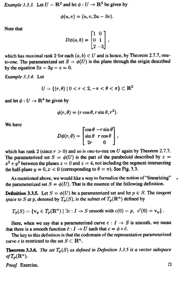

You can imagine the following situation. Think of ##S## being the city in which you live, ##p## your home and ##U## a roadmap of it.
The formula basically states that you can use a path ##I## on your map and project it to the actually city as well as finding it in reality.
The point is that ##S## can be of any shape, e.g. curved (or with hills in the example above).
Smoothness is a local property, i.e. it holds on small neighbourhoods around ##p##, even if for any ##p##. Instead to define what small neighbourhoods in ##S## are, we take a chart ##(U,\phi)## of ##S## in ##ℝ^n## where we already know what smooth means and define it with the help of ##\tilde{c}## and the requirements that ##\tilde{c}## is smooth and ##c=\phi \cdot \tilde{c}##.
