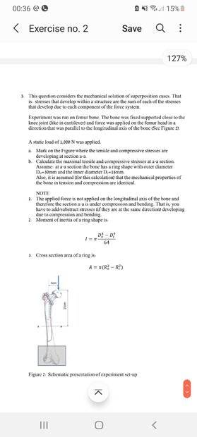

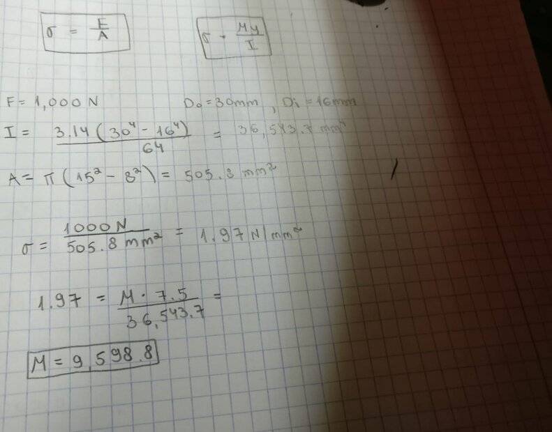

Summary:: Hello all,
I need help with this question, ill attach the equations i managed to solve.
How do i continue from there?
The stress should be expressed as N/m^2.
I have no idea how you determined the moment, but it certainly is not determined by the equation that you employed. It should be the force times the moment arm.
Looks like they found the axial stress and set it equal to the bending stress, which is incorrect. They should each be solved for by their respective equations.
I don't think there's anything inherently wrong with N*mm^-2, which is MPa, as long as the units are properly tracked. That said, the final answer doesn't even have any units with it.
