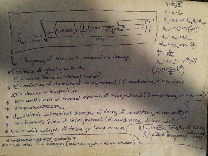

At one point I had been trying to construct an equation which would calculate the tension on a tuned string with a change in temperature (and therefore the fundamental frequency), but found my calculations were wrong. By extension, the purpose of the project was to be able to calculate what frequency the string should be tuned to beforehand so that with a change in temperature the change in tension will retune the string to the desired final frequency. For the sake of clarity and realism let's say that the string instrument is an electric guitar equipped with a double-locking tremolo where the tremolo is also 'blocked', which means that the tremolo does not move with a change in tension, and the effective length of string is merely the scale length of the instrument (i.e. the length of string from the locking but to the locking bridge). Let's also say that the body, neck, and headstock of the instrument remain immobilized even when all strings at their maximum tensile strength.

I started out with the equation for frequency:
fΔT = ( 1 / ( 2 * L ) ) * sqrt( G * F * ( m / L ) )
where
'fΔT' is the string's frequency,
'L' is the string's length (or rather, the distance from the edge of the string's slot in the nut to the slot on its corresponding saddle),
'G' is the force of gravity,
'F' is the force of tension on the string, and
'm' is the total mass of the vibrating portion of the string.
Then I considered how if 'F' is the force on the string after it has experienced a change in temperature, so 'F' became
F = F0 + FΔT
F0 => T0
where
T0 is the tension already on the string before the temperature change, and
FΔT is the extra force (or lessening thereof) with the change in temperature.
After that I used the equation for change in length resulting from a change in temperature, as well as the equation for the 'Tensile Modulus' (AKA "Young's Modulus")
ΔL = α * L * ΔT
where
'α' is the coefficient of thermal expansion, and
'ΔT' is the actual change in temperature ( T - T0, where T is the temperature the string will be exposed to)
E = ( F / A ) / ( ΔL / L )
F => F0 => T0
A => A0
=> ΔL = ( T0 * L ) / ( A0 * E )
where
'E' is the string material's modulus of elasticity, and
'A0' is the string's diameter before the change in temperature (but not before the string was initially pulled taught, so we still need to work our way back to those dimensions of the string that we can know existed before any tension was applied)
Anyway, I set both equations for ΔL as being equal to each other and solved for F (i.e. FΔT)
( F / L ) / ( A0 / E ) = ΔL = α * L * ΔT
F = α * ΔT * A0 * E
=> FΔT = α * ΔT * A0 * E
From there we start into the equation for area of a circle
A0 = ( π / 4 ) * d0^2
where
'd0' is the string's diameter before the change in temperature
Then I considered the fact that as tension is applied and the string's length changes, the string's diameter also changes
d0 = di + Δdi
where
'di' is the string's pre-taught (or 'initial') diameter, and
'Δdi' is the change in that pre-taught diameter
That being the case, the equation for change in diameter with change in length (i.e. Poisson's Ratio) would also come into play
Δdi = -di * ν * ( ΔL / L )
where
'ν' is the Poisson's Ratio of the string material
Thinking back, the expression '( ΔL / L )' sounded much like the earlier equation involving the modulus of elasticity, so I solved went back and solved that equation for '( ΔL / L )'
ΔL / L = T0 / ( E * Ai )
where
'Ai' is the pre-taught diameter of the string, and
Ai = ( π / 4 ) * di^2
Finally, the single equation I've forgotten until now: the equation for tension on a string
T0 = ( ( m / L ) ( 2 * L * f0 )^2 ) / G
where
'f0' is the frequency the string was tuned to before the change in temperature.
When I put all of this together for an equation that would, at the very least, tell me the frequency of the string after the change in temperature, I got this:
I was able to rewrite it so that I could do what I had outlined in my original post: what to tune a guitar string to so that the change in temperature brings the string 'in tune' (solve for f0), but I think it simply did not work...
Before anyone replies, please understand that I am an undergraduate Music Education major, studying percussion, but I have a passion for Physics and Mathematics (I took Calculus AB my senior year of high school, and am currently taking a Discrete Mathematics and Pre-Calculus class). I want to understand just why an instrument works and, more importantly, HOW it behaves (its quirks), for the purpose of being able to learn how to play an instrument MUCH faster and what balance of mechanics different pieces of music exercise and the more exact level of skill they require, as opposed to simply going through nothing but the 'traditional' methods. I would call myself a Musicologist (and inventor), weighted heavily towards physics).

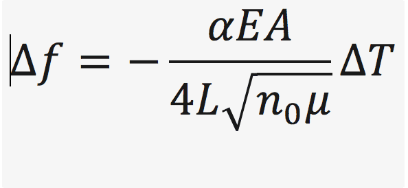

Oh. It's just my writing the 2 in the wrong place. Sorry. I didn't even notice my error. Thanks for spotting it. If you'd like, I'll go back and correct my earlier post.

Hi, Chet, I am 17 years old and I have tried hard but I can't figure out how you linearised this equation, could you be so kind as to show me the steps, or to start me off?
Also I have been looking everywhere for the thermal expansion equation ΔF=−αEAΔT , and I have been unable to find it, could you show me how you have derived this?
Many thanks.

If we factor out ##\sqrt{\frac{F_0}{\mu}}## from ##\sqrt{\frac{F_0-(αEAΔT)}{μ}}##, we obtain:
$$\sqrt{\frac{F_0-(αEAΔT)}{μ}}=\sqrt{\frac{F_0}{\mu}}\sqrt{1-\frac{αEAΔT}{F_0}}$$
From the binomial expansion, we know that, if x is small, to linear terms in x, $$\sqrt{1-x}\approx 1-\frac{x}{2}$$

Thank you sooo much I really really appreciate it, I had a look back at the equation linking Tension and Temperature, and I understand it completely now!
I also managed to linearize the equation thanks to your tip!
However it is to my understanding that you accidentally used:
2/L* sqrt(F0/u)
when it should be:
1/2L * sqrt(f0/u)
therefore in the final equation, we should get:
where there is a 4L on the denominator, although this doesn't change the relationship but just the coefficient, I would like to point that out :)
again thank you for the help I much appreciate it!

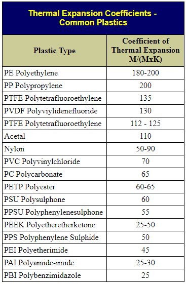

Thermal Expansion equations?
steel string or nylon?
for most materials they say delta L is directly proportional to delta Temperature.
we just need an equation to convert Delta Temp to Tension
so a certain tension creates a certain note.
thats what you guys were working on right?
Nylon 50-90 M/(MxK)
what kind of unit is M/(MxK)?
the website says:
"The calculation is: (given factor) x 10-6 x length x change in temperature °C"
but I don't know how to interpret it.
Xilus said:
Nylon 50-90 M/(MxK)
the website says:
Those units mean "meter per meter per degree K." The first M refers to the change in length of the sample, the 2nd M refers to the original length of the sample, and the K refers to the change in temperature of the sample. Obviously the M's can be canceled (since we are really talking about the strain in the sample, which is dimensionless), and we are left with units of 1/K.

You did a very impressive analysis for a guy who is doing music education. Dazzling in fact.
I have a few comments. It is not necessary to take into account the change in the cross sectional area because that is negligible. So this should simplify things considerably.
The G doesn't belong in the equation for the fundamental frequency (since gravity has nothing to do with this). The equation should read:
f=2LFμ
where L is the clamped length of the string, F is the tension in the string, and μ is the linear density of the string (mass/length).
The equation for the change in tension is:
ΔF=−αEAΔT
where α is the coefficient of thermal expansion, E is the Young's modulus, and T is the temperature.
So if f is the frequency at temperature T0 and tension F0 and f + Δf is the frequency at temperature T0+ΔT and tension F0+ΔF, then
Δf=2LF0−(αEAΔT)μ−2LF0μ
If we linearize this with respect to the temperature change ΔT, we obtain:
Δf=−EAαLF0μΔT
The fractional change in frequency is:
Δff=−EAα2F0ΔT
According to these equations, when you increase the temperature, the frequency decreases (because the string expands and "slackens").
Chet
