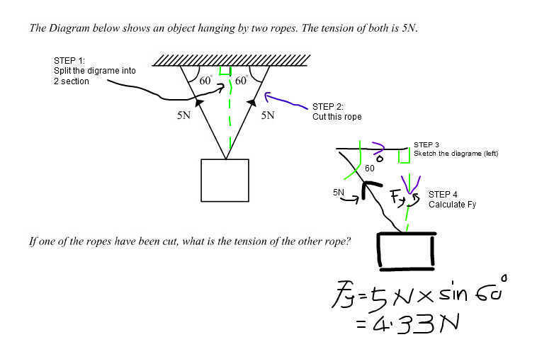

Attached is the calculation..any one can verify my ans (4.33N) because the given ans in 5N.
Update:Wrong Arrow for Fy
Attached other option ans
As I posted, the first step is to determine the weight of the mass. No, it's not given, but there is enough information to find it. To do this, just consider the initial set up with two ropes. Write the equation for balance of forces in the vertical direction.
You got 4.33 N for the upward component of force contributed by each wire. But there are two wires. So what is the weight of the object? If this weight has to be supported by only one wire, what would the tension in that wire have to be?

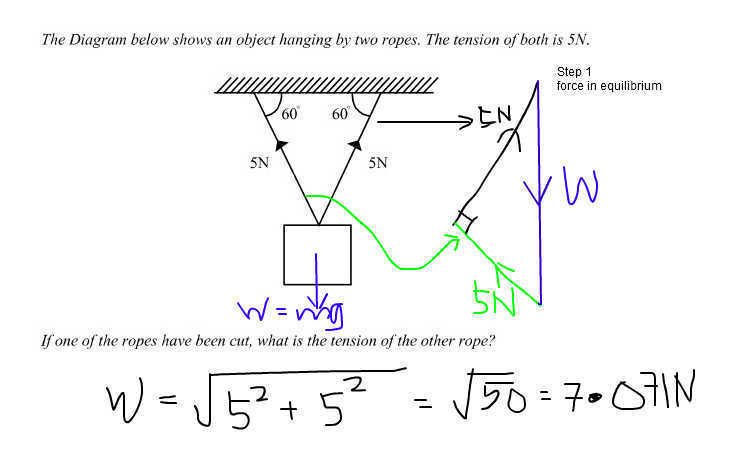

My step to determine the weight of the mass..is it ok? (weight of the mass = 7.071N)
Chet
No, that doesn't work. Pythagoras applies when two vectors at right angles are to be added.
In this figure, the 5 N should be the hypotenuse, not one of the other sides. You're using the wrong triangle.

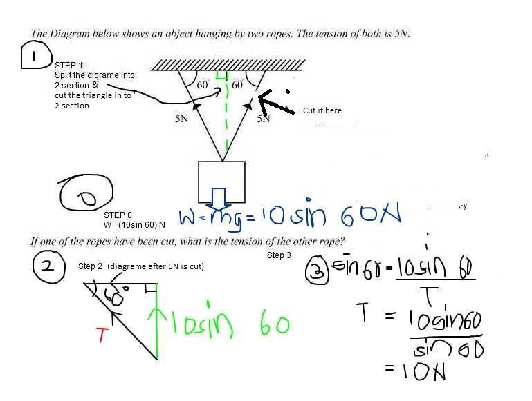

the ans is 10N after cut the 5N right rope...huhu near but still cannot get the ans
After a rope is cut, the system is no longer stable. There will be an acceleration. The forces in the vertical direction will no longer balance.
You need to consider which way that acceleration will be and apply ##\Sigma F=0## at right angles to it.

if one of the ropes have been cut, it mean the object just hang VERTICALLY with one rope with 10sin(60)N load on it.Is it my assumption is correct?
it mean all the calculation in step 25 not require especially step 2 &3 ?
Not immediately. Although the question does not make it completely clear, I am very confident that you are supposed to find the tension in the remaining rope the instant after one rope is cut. You can take the remaining rope and the mass as being in exactly the same positions as before, and, for the instant, stationary. But now there is a nonzero acceleration.
Which way will the mass accelerate?
Likes stuc

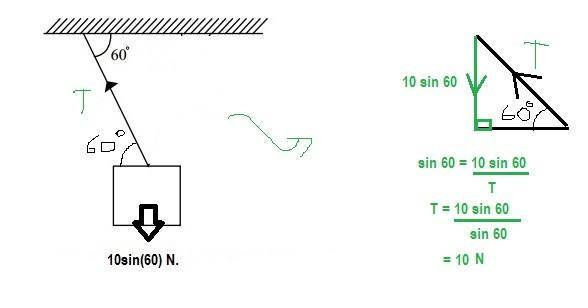

dear haruspex ... is it like this?
  • #33
The free body diagram is right, but you need to think about which way the acceleration must be. In your force analysis, you have summed the vertical components and assumed the total to be zero. In other words, you have supposed the acceleration to be horizontal. Clearly it will not be. Which way will it be?
