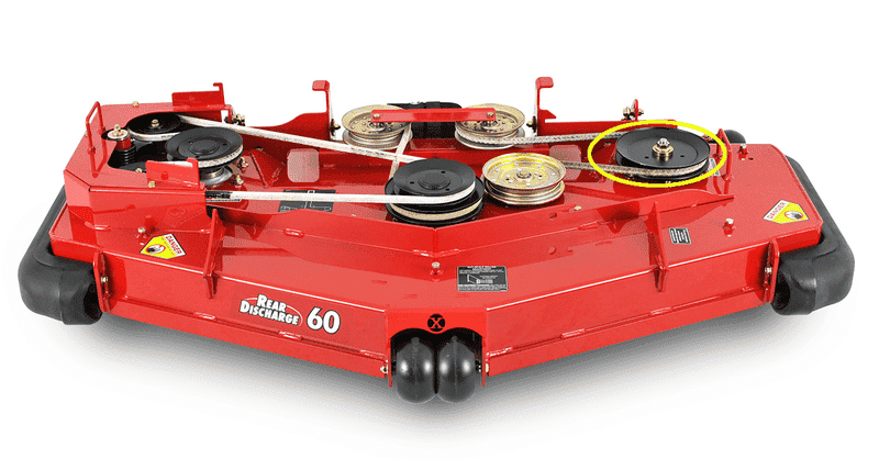

@berkman, this is for a future setup so there isn't anything to photo just yet. But to give you an idea, I'll be reading the speed from a spindle on a lawnmower deck.
I circled a pulley as an example. I will need to track it's RPM.

hmm... that seems too easy to be true... I would have to get information on the machine to make sure it has clearance to lay on the encoder and to mount the optical sensor. Is there an optical option that would be able to read RPM from viewing the pulley/shaft from a radial perspective? In case vertical clearance is an issue.
If you could put marks on the outside of the belt, you could bounce the LED source off of the belt and into the pickup device...
Put a mirror above the pulley at a 45 degree angle, then mount the sensor off to the side.
Put a spot of paint, White or metallic, on the rim of the pulley to optically sense with a reflective sensor.
If that is a photo of the real item, I notice that there is a pulley at the left side that is raised above the deck. Perhaps you could sense the underside of that pulley. It would be easier to get a solid, vibration free, mount down closer to the deck there.
Overall though you will be much better off with a magnetic sensor in an environment that dirty. Fortunately the pulleys are stamped/assembled with holes and rivet heads in them, ideal for magnetic sensing.
