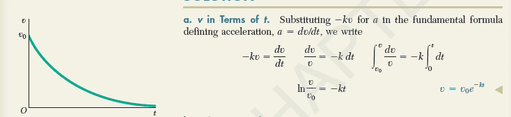

The brake mechanism used to reduce recoil in certain types of guns consists essentially of a piston which is attached to the barrel and may move in a fixed cylinder filled with oil as the barrel recoils with an initial velocity v0, the piston moves and oils is forced through orifices in the piston, causing the piston and the barrel to decelerate at a rate proportional to their velocity; that is, ##a=-kv##. Express v in terms of t, x in terms of t, v in terms of x. Draw the corresponding motion curves.

Substituting -kv for a in the fundamental formula defining acceleration, a=dv/dt, we write
##\ \displaystyle -kv=\frac{dv}{dt} \ ## ; ##\ \displaystyle \frac {dv}{dt}=-kdt##
##\ \displaystyle \ int_v_0^v \, dx = \left. -k \int_0^t \, dt \right \ ##
## \ \displaystyle ln\fracv_{v_0}=-kt ##
I have made mistakes when doing latex. So I paste official solution. I understand most of it but the confusing part is that when integrating why the author did not use integration constant?
Source: Vector Mechanics for Engineers by Beer/Johnston.
Thank you.
He did use one: ##v_0## and the other, ##t_0## is zero (the moment of firing)
Another way to look at this: if F is a primitive of f, then ##\int_a^b f = F(b) - F(a)## (no integration constants: they cancel)

I have forgotten some rules of integration. Isn't there any integration constant in definite integral?
$$F'(x) = f(x) \Rightarrow \int^x f(u) \, du = F(x) + C \ \ {\rm and }\ \left . \int^b_a f(x) \, dx = F \right |^b_a = F(b)-F(a) $$
Because definite integral would be a number which is the diffference of two values of a function and these two values have the same constant, these constants will cancel out, right?
