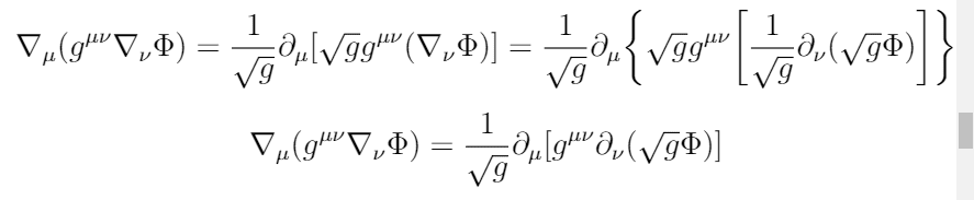

In my calculations I did something like this
but it seems wrong ... But I see your point.
I don't understand, how you get from the 2nd to the 3rd expression. Of course ##\nabla_{\nu} \Phi=\partial_{\nu}\ Phi##, and then you get the correct expression, the Laplace-Beltrami operator.
how so ?
By using this I am getting
$$\nabla_{\mu}(g^{\mu \nu}\nabla_{\nu}\Phi) = \frac{1}{\sqrt{g}}\partial_{\mu}[g^{\mu \nu}\partial_{\nu}(\sqrt{g}\Phi)]$$
but you are writing
$$\nabla_{\mu}(g^{\mu \nu}\nabla_{\nu}\Phi) = \frac{1}{\sqrt{g}}\partial_{\mu}[g^{\mu \nu}\sqrt{g}\partial_{\nu}(\Phi)]$$
there is a ##\sqrt(g)## difference. In my its inside the partial and in yours its outside..
As I said, I don't understand your step. Can you prove it?

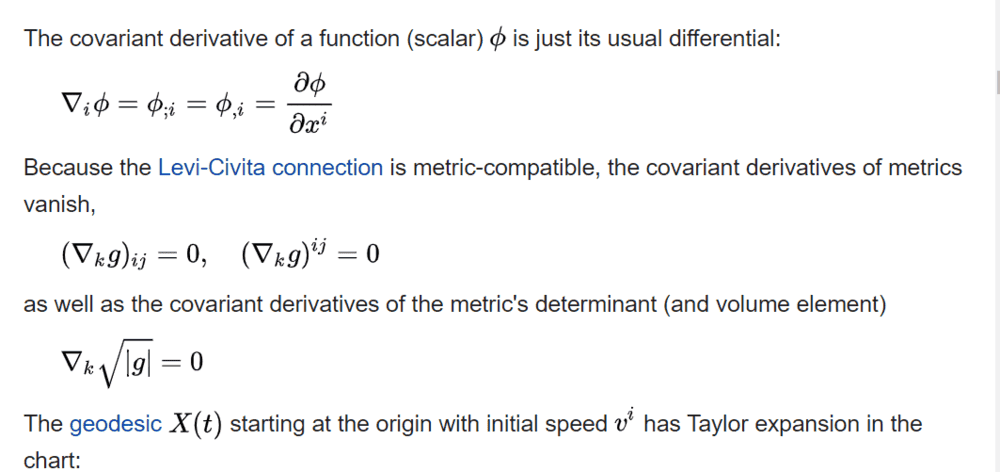

I have just put the definiton of the ##\nabla_{\nu}\Phi = \frac{1}{\sqrt{g}} \partial_{\nu}(\sqrt{g}\Phi)## inside the paranthesis ?
No! The definition of ##\nabla_{\mu} \phi=\partial_{\mu} \Phi##. ##\Phi## is a scalar field!
Likes Arman777
