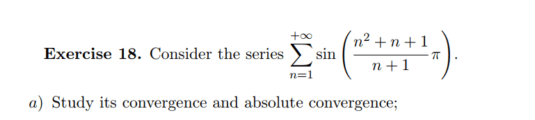

here is the exercice
My solution was
as n^2+n+1/(n+1) tends asymptotically to n then the entire stuffs inside the sinus function tends to npi which make it asymptotically equal to sin(npi) which is equal to 0 and consequently the sequence is Absolutely convergent

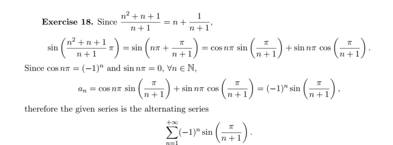

Here is the solution of the book
I do unsderstand it very well but I need to know where my logics has failed me in my attempt

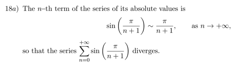

To say that the terms are asymptotically equal to something does not say enough. It doesn't say how fast it approaches that limit. For instance, ##\sum{1/n}## doesn't converge even though ##1/n## approaches 0 asymptotically.
Likes Amaelle and Orodruin
You can make the non-convergence rigorous by using the inequality [tex]
\sin x > \frac{2}{\pi} x, \qquad 0 < x < \frac\pi 2.[/tex] Then [tex]\sum_{n=0}^N \sin\left(\frac{\pi}{n+1}\right) > \sin\left(\frac{\pi}1\right) + \sum_{n=1}^N \frac{2}{n+1} = 2\sum_{n=2}^{N+1} \frac 1n[/tex] which diverges.

I wanted to say as
sin[pi*((n^2+n+1)/(n+1)]≈sin[pi*((n^2)/(n)]≈sin[pi(n)] and we know the serie ∑sin[pi(n)] converges SO IS MY SERIE
Once again, your "##\approx##" is not enough. It depends on how fast the terms on the left come close to the terms on the right. Consider ##1/n \approx 0## as ##n## gets large. But ##\sum{0}## converges while ##\sum{1/n}## diverges to ##+\infty##.
