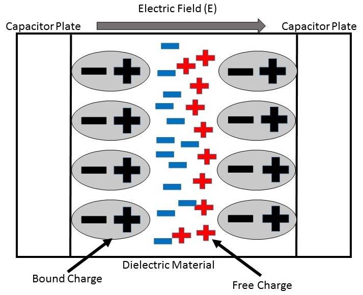

conductor between the charges gets polarized.
hokhani said:
The main question is:
How does the force between the two point charges change if we put a conductor between them? (increase, decrease or no change)
Maybe you should re-read your own post. Here's what you wrote in the original first post:
hokhani said:
How does the force between the two opposite charge change if we place a substance (conductor, insulator, ...) between them? It seems that the force between the two charges doesn't change but the total force on each charge increases because of the superposition of the original field of the other charge and the extra electric field due to the induced charge on the substance. I would like to know if I am wrong.
I simplified one part of the question by suggesting something that you can look up easily as an analogous situation. but I guess learning something is not what you're interested in.
Zz.
