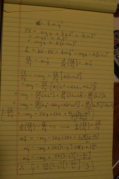

Thanks for the replies everyone! I must admit that I'm not a student, I am an adjunct Professor at a community college, teaching Engineering Dynamics. I understand how the book says to solve the problem: here's my issue:
We arrive at the Conservation of Energy by integrating the conservative forces with respect to the change in displacement. In this case, however, there are moments in time (the final state) where the force of the spring can do NO work on the system. My question is: If we were rolling a ball horizontally on a table, we wouldn't include gravity because gravity is doing no work on the system. I feel as though the spring terms should have some kind of 'Sin(theta)" which allows the work done by the spring to be zero when perpendicular.
One more point which I think proves my assertion: If you calculate the Newtonian equations of motion for this problem and then calculate the Lagrangian equations of motion for this problem -- they are only identical when you take this sin(theta) term into account!

OK everyone, I'm attaching the Newtonian and Langrangian equations of motion... Aside from a discrepancy with one negative sign (whoops) they are identical under these conditions:
-In Newtonian, the spring force varies with the Sin(theta) (written in terms of y and the width of the system)
-In Langrangian, the potential energy of the springs are functions of y, unstretched spring length Lo, and width of the system.
If you calculate the Potential when y = h (the ceiling in my textbook), there IS a potential energy unless the width = Lo. This is consistent with what you guys are saying (and the book solution).
So I guess I was wrong/right... The potential energy of the springs IS a function of the angle that the spring is at, but even so, unless the spring returns to unstretched length, there is a NONZERO amount of energy in the system regardless of whether or not the spring can do work on the system.
Still a bit strange to me because of how we derive potential energy from work, but oh well...

You were doing pretty well for a while there on the Newtonian analysis, although you have a sign error on the 2k term. I'm going to go back to your third from last equation with the sign corrected:[tex]\frac{d^2y}{dt^2}=-g+\frac{2k}{m}\left((h-y)-L_0 \frac{(h-y)}{\sqrt{x^2+(h-y)^2}}\right)[/tex]
Now, suppose I multiply both sides of the equation by dy/dt:
[tex]\frac{dy}{dt}\frac{d^2y}{dt^2}=\frac{1}{2}\frac{d}{dt}\left(\frac{dy}{dt}\right)^2=-g\frac{dy}{dt}+\frac{dy}{dt}\frac{2k}{m}\left((h-y)-L_0 \frac{(h-y)}{\sqrt{x^2+(h-y)^2}}\right)[/tex]
This equation can be rewritten as:
[tex]\frac{d}{dt}\left(\frac{mv^2}{2}\right)=-mg\frac{dy}{dt}-k\frac{d(h-y)^2}{dt}+2kL_0 \frac{d}{dt}\sqrt{x^2+(h-y)^2}[/tex]
[tex]\frac{d}{dt}\left(\frac{mv^2}{2}\right)=-mg\frac{dy}{dt}-k\frac{d(\sqrt{x^2+(h-y)^2}-L_0)^2}{dt}[/tex]
[tex]\frac{d}{dt}\left(\frac{mv^2}{2}+mgy+k(L-L_0)^2\right)=0[/tex]
Does this answer the OP's question?
