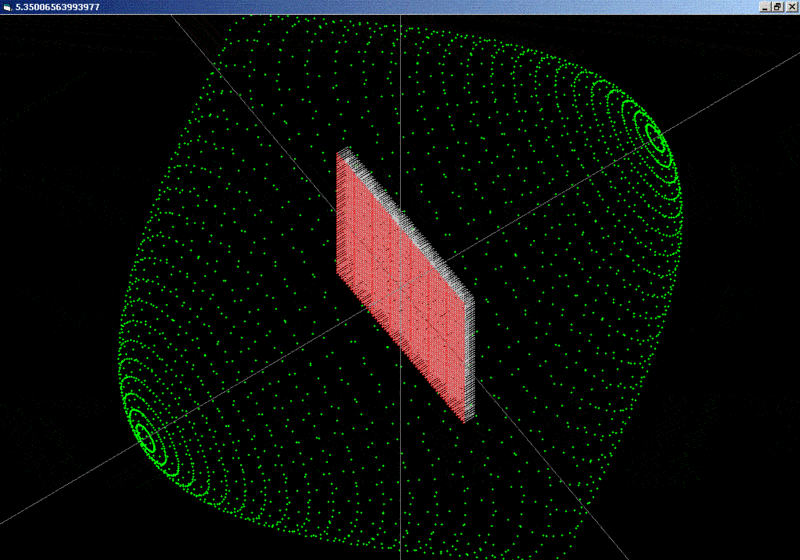

Geometry. Attached is a picture of a program I wrote to test the relative field strength and vectors given different coil geometies. I found that two solenoids or flat coils do not create uniform magnetic fields along the surface of a disk between them, but it's fairly close at long as the disk is smaller than the coils. It appears that two hemisphere-shaped coils (as shown in the picture approximately) can create a uniform field across the disk surface. Another example is shown http://web.mit.edu/6.013_book/www/chapter8/ch8-853.gif". This is a relatively complex thing to accomplish, and doesn't suit well to using a core. If [Q2.b] is true, then it might be a good option.
[Q3.a] Are some of the properties of the generator derived from the non-uniformity of the magnetic field on the disk? http://www.stardrivedevice.com/Tesla_notes.html" on the device kind of states that when only a part of the disk is covered by magnetic fields, it can be made self-exciting. However, it will function a bit differently when the whole surface is covered, and perhaps especially if the field is more uniform.

[3]
