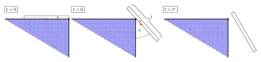

Consider the following sketch.
241363
(Forgive me if it isn't completely clear, I didn't want to fiddle around for too long with tikz...)
Let us assume that we can approximate a piece of toast as a rectangle with homogenous mass distribution ##m## and length ##l##. We further assume that for ##t=0## the toast has velocity in positive ##x## direction. We can describe the system over the two generalized coordinates ##s## and ##\theta##, where ##s## gives the distance from the center of mass to the coordinate frame center (let us for now assume that the toast is infinitely thin... Not sure if this is necessary though) and ##\theta## beeing the angle between the toast and the ##y## axis. We can then write for the center of mass

PS: the third picture should just indicate that one can find ##t^*## with the condition ##(\ddot{x_p})_x\overset{!}{=}0## for which the toast loose its contact to the table.

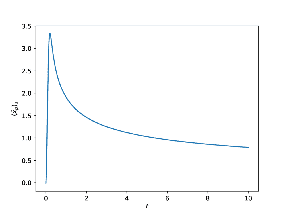

Me neither, so I just decieded to try it numerically but I'm already running into problems.. Mainly due to the fact that the condition I wanted to use to determine ##t^*## doesn't really lead to anything. If I calculate the second derivative of the ##x##-component of ##x_p## I get
$$(\ddot{x}_p)_x = \sin(\theta(t)) (\ddot s(t) - s(t) \dot\theta(t)^2) + \cos(\theta(t)) (2 \dot s(t) \dot\theta(t) + s(t)\ddot\theta(t))\overset{!}{=}0 $$
but Mathematica tells me that there are no zero values for this function (for the numerical solutions I obtained..)

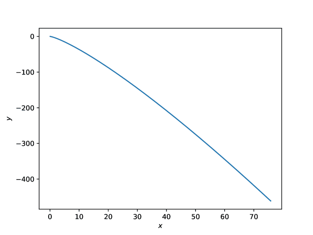

Solving this numerically isn't really an issue and plotting the trajectory with inital values
$$s(0)=l/2,\quad \dot s(0)= 0.3,\quad u(0)= \pi /2,\quad \dot u(0)= -0.1$$
gives

and if I plot ##(\ddot x_p)_x## I get this (cannot upload second image directly...). I don't really see how this can be.. At some point ##(\ddot x_p)_x## needs to be zero for the bread to lose contact to the table, but apparently this doesn't happen.. Can someone explain this?
