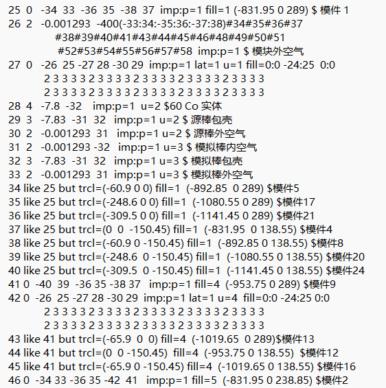

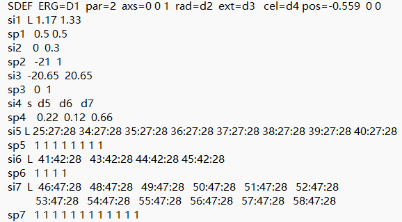

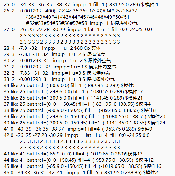

I'm using the fill card to repeat the 60Co source to simulate the radiation source in the irradiation chamber, the code works, and the vised shows the graph. But it just doesn't end. Thank you very much for your request.

Hi @momomo,
Welcome to Physics Forums. I can't fully read your SDEF line. Are you able to share your input file? If you are then changing the file name to add .txt will let you add it as an attachment.

These versions seem unfinished, but when I removed the bits that were complaining it did just hang the program.
My quick answer is "I don't know". You seem to be building a 2D lattice by translating a 1D lattice. That may be not the best way to do it. I suggest you define a 2D lattice. If nothing else this should be easier to debug.
I will look again when I have more time.
