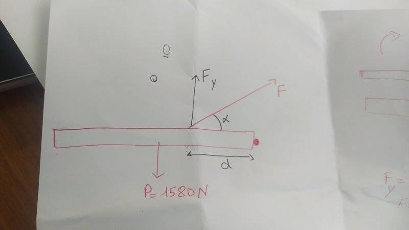

The necessary inclined force to rotate an object around an axis
In summary: Just checking... your diagram implies this is a trapdoor, not an upright door, yes? So the further from the hinge the force is applied, the smaller the angle will necessarily be. Yes, it's a trapdoor.Yes, it's a trapdoor.
chane
I just want to ask if is it possible to find the force F, the angle "alpha" and the distance between the force F and the pivot just with the door weight. Or I have to make an assumption of the angle or the distance.
Btw the object lenght is 2150mm
Fy = F*sin(alpha)

Can you explain what you are trying to do?
Likes chane and Zeekiel
I am trying to rotate the door around the pivot (red dot) using an inclined force
Then you have to specify ## \alpha ## if you are to find the force ## F ##
Likes chane
... The required force depends on both the angle ##\alpha## and the point at which the force is applied. For physical reasons it's optimum to have ##\alpha = \frac \pi 2## and ##F## applied as far from the pivot as possible. Your equations should lead to the same conclusion.
Likes chane
So I have to suppose alpha and make my calculation around it
Just checking... your diagram implies this is a trapdoor, not an upright door, yes? So the further from the hinge the force is applied, the smaller the angle will necessarily be. I.e. ##d\sec(\alpha)## is fixed as the string or arm length.
If you want to take friction into account, note that ##F\cos(\alpha)## contributes to the normal load at the pivot.
