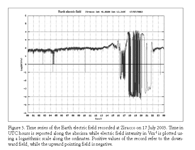

Certainly not by me. Earth has a field on order of a hundred volts per meter or so near its surface.
http://www.siencis-par-furlan.net/wp-content/uploads/Bressan.Ground.pdf
Likes Babadag, Fisherman199 and Tom.G
I'm having a problem with that figure of 100V/m and what it actually means to the man in the street. According to the paper, it's not the value that you would get near the surface of a metal sphere in space. If it were, the overall absolute would be something like 3X1014V
I used the inverse law for potential so
V(1/r1 - 1/r2) = ΔV
where V is the absolute potential and ΔV is the volts per metre. r is about 6000km
How much net charge would this imply? The Capacitance of the Earth, treated as a conducting sphere, is around 700μF and Q=CV so
Q would be 3X1014X700X10-6 = 3X108 Coulombs. I think that would be negative (?)
That charge isn't a lot. It would represent, say 100A flowing for about 1000 hours .
Please check my maths.
But the paper is dealing with local field strength and the variation over time takes the value both positive and negative. Plus the change with height doesn't follow 1/r. So where does that lead us in justifying using Earth as 0V?

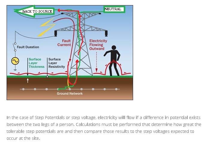

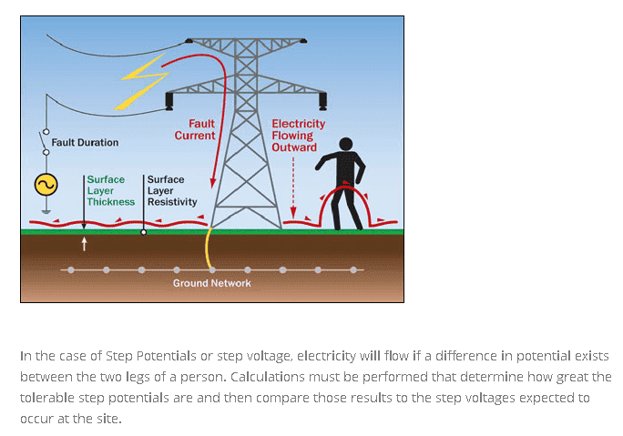

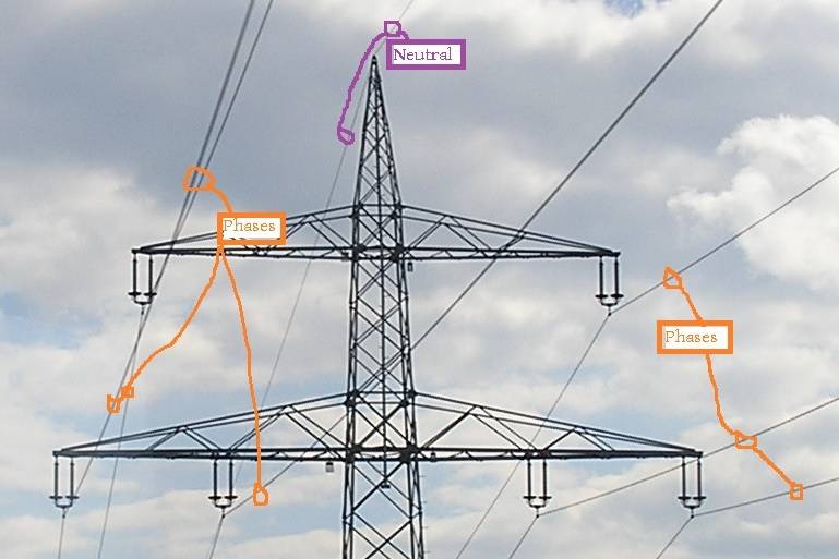

Regarding power systems, generally Earth is only used as a local reference and not for returning load current, dirt is not a very good conductor!
3 phase HV lines are generally delta connected and don't need a neutral, HV DC transmission have both pos and neg on the lines, Earth is only a reference for the converter/transformer/end user.
Right. Perhaps I wasn't clear. I'm not saying Earth is conducting to the source. That's the neutral conductor's job, if there is one.
My point is that many electricians and lineman I talk to are convinced that, once something touches Earth reference, it becomes safe. That's a deadly misunderstanding.

http://www.esgroundingsolutions.com/what-is-step-and-touch-potential/
They design a switchyard grounding grid (network in that image) to hold voltage drop along 'ground' during a fault to a small enough number of volts per meter that it won't electrocute that unlucky fellow standing underneath the line. I don't know about transmission line towers..
That's a misleading statement that i found posted on Stackexchange...
The lines themselves are just wires. It's the transformers at their ends that are connected wye or delta.
At my plant the main generator stepup transformer had a 24KV delta primary fed by the generator, and a 240 kv wye secondary feeding the switchyard.
So our HV lines were fed at their source end by a wye connected transformer.
Using a delta connected transformer at their load end would force neutral current to ~zero allowing neutral to serve as just a lightning rod under normal conditions. That was important in South Florida.. It also gives a return path via wire for fault current.
any help ?

Another consideration is that a Delta connected transformer winding nearly eliminates third harmonic distortion.
There's a long discussion at Stackexchange .

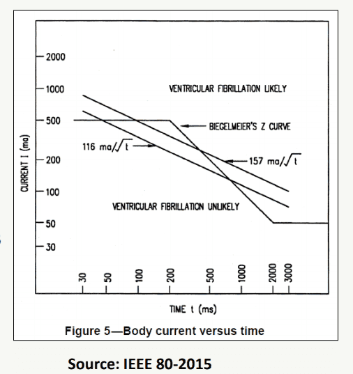

Here's an interesting thing relating likelihood of ventricular fibrillation to the time and magnitude of electric current exposure.
