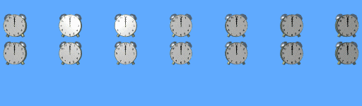

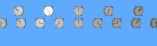

So the thought experiment starts off assuming something like this:
But when you switch to the the frame in which the top row of clocks are at rest, you get this:
Likes malawi_glenn, Dale and Sagittarius A-Star

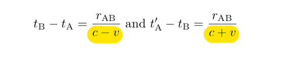

Einstein defines his method of synchronization using the times of flight of a ray of light from A to B, and from B back to A, in order to find a common time for A and B that accounts for the time of flight between them.
“In accordance with definition the two clocks synchronize if t B − t A = t A − t B”
Assuming the one-way time of flight, as Einstein does in the original paper, his synchronization method finds a difference between the two legs when the rod is moving relative to the stationary system. The difference is a measure made by the observers moving with the rod and the difference is explicitly attributed to the motion of the rod relative to the stationary system. (Please see his concluding equations for confirmation, I have not learned LaTex yet.)
