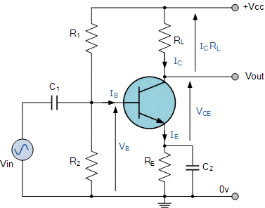

In CE amplifiers with negative feedback I can't understand what it means that the emitter becomes more positive (when hfe increases and VE increases with it). Does it mean that there is less negative charge after the emitter resistor (going from ground to Vcc) and the emitter feels some positive charge and the potential difference between the emitter and the base is decreased or what? Physicaly I can't explain it. Not theoreticaly, but physicaly. Help me with this one if you can
EDIT#1 I understand that electrons in the - terminal of the battery, in order to flow through the circuit, they must be given the needed potential energy. This potential energy - the energy density of a charge J/C is the thing the electrons need so that they can actualy start a current. By flowing from ground to the high potential, the electrons inevitably encounter resistance and they lose this energy to heat. And when they arrive at Vcc they have already spend all of the potential energy given to them to fulfill this "journey". But how can I imagine the rising emitter voltage VE duo to negative feedback?
Not certain I understand the question. I assume an NPN and a bias network. Also a Vcc to collector resistor and an emitter to ground resistor. Where is the negative feedback resistor?
This is it. When Hfe increases, Ic increases and so does Ie and the drop across RE also increases, making the emitter more positive and you know how the feedback works from there on. Similar thing is when in a voltage divider the output falls below a certain level and there is not enough voltage to say turn on a led or a transistor. I am not sure how the voltage manifests. Is it the emitter actualy gaining some positive charge or I don't know.
So are you saying that you don't understand how an increase in emitter current through RE can cause a larger voltage to be developed across RE?

For my opinion - two basic questions:
1.) Is there any negative feedback caused by RE?
Answer: Of course - that is the only purpose of RE. Any unwanted increase of IC resp. IE (temperature or beta-variation) increases the voltage drop VE across RE and, thus, enhances the emitter potential. The emitter current IE is determined by VBE (exponential relation) - and the voltage VBE=VB-VE decreases correspondingly because the base potential VB is kept relatively constant (for this purpose the resistors R1 and R2 are chosen such that any change in the base current has only minor influence on the base potential). Hence, we have current-controlled voltage-feedback. This feedback stabilzes the currents IE and IC against unwanted influences.

Could it be so simple as it's a matter of not feedback but biasing ?
Good circuit design is tolerant of variations in the transistor parameters.
In your mind
Increase Hfe tenfold. What happens to IB ? 90% of it swaps over to flow down through R2, which raises voltage VB by a little bit.
Good design will have R2 low enough value that the voltage change won't be much, but it would be measurable with a decent DMM.
Vbe being basically constant, KVL tells us voltage at emitter must also rise by very nearly the same amount.
No feedback theory required.

Jim Hardy - of course, you are right. The working principle of all simple feedback loops can be explained without using "feedback theory".
However, why not using the correct term in this case? It is a technical fact that RE provided negative feedback - I am sure you will not disagree.
And all relevant formulas confirm this.
For example, the signal gain as well as the signal input resistance are decreased resp. increased by the same factor k=(1+gmRE).
Please realize that this factor k is in full agreement with feedback theory k=(1+loop gain).
For my opinion, for a good understanding of the working principle of electronic circuits it is important to know if the circuit contains feedback or not (important for dynamic stability aspects).
Quote Jim Hardy: "Good circuit design is tolerant of variations in the transistor parameters."
Yes - and that is one of the most important reasons for applying negative feedback in electronic circuits (typical example: Operational amplifier).
