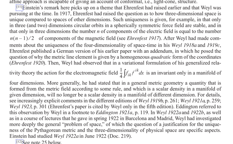

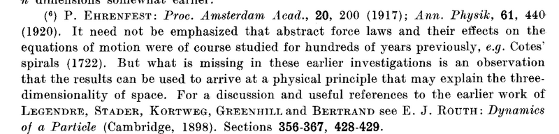

I have found an interesting rabbit hole, because I thought the question of why we live in 3+1 was mainly a matter of footnotes and off-press debates. But it seems if was touched early by Weyl, Ehrenfest and Whitrow
https://einsteinpapers.press.princeton.edu/vol13-doc/764
And then elaborated for Schwarzchild metrics by Tangherlini, who seems to be the root citation nowadays.
Is there any other relevant literature? What have you read on the topic? How does modern theory evade Eherenfest's arguments?
