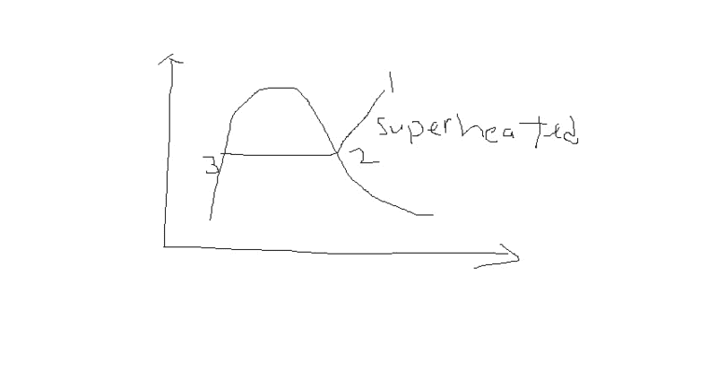

yeah.. the saturation T is 179.91C but the initially T is 400C so it is saturated vapour. and i got 2957.3
Your ##u## is correct, but it's really superheated water vapor as it says at the heading of the table A-4
yeah.. i thought the situation is like that. initially the
What's on the axes ? And: what makes you think that ? Or are you just guessing ?
For the record: point 1 could be correct.
Sorry, i think this is 1 should be correct. First the water is superheated then same volume to cool down. then same temperature.

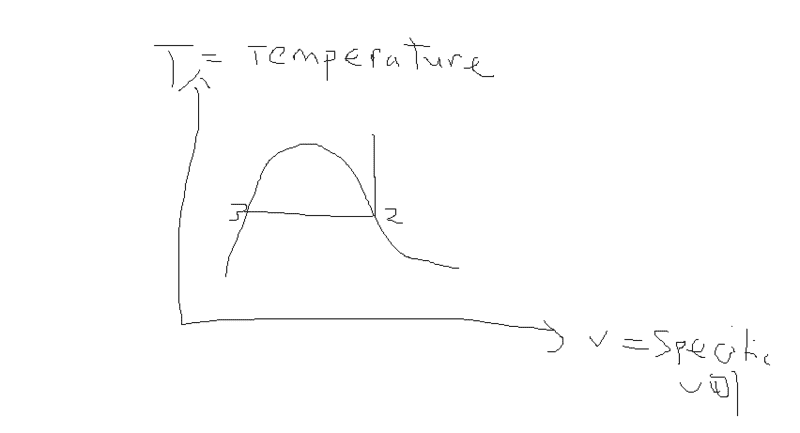

Much better ! Now we have to underpin it to see if it's right.
BvU said:
What's the situation after cooling down to 150 ##^\circ## at same volume ?
For the record: point 1 could be correct, point 2 and 3 I'm not so convinced
What is the specific volume of superheated steam at 10 bars and 400 C? At 150 C, would that same specific volume lie between that of the saturated vapor and the saturated liquid?
Good point ! Welcome in this thread !
the specific volume is gradually decreased with the T decreased. mean that the graph for the 1st time is correct.
We have the given that the volume stays the same during cooling down in the first stage. So what does that mean for the situation (as I asked in #6) ? (note what Chet asks in #15 too)
At 10 bars and 400 C, the specific volume of the superheated steam is 0.3066 m^3/kg. At 150 C, the specific volume of the saturated vapor is 0.393 m^3/kg and the specific volume of the saturated liquid is 0.001091 m^3/kg. What does this mean to you?
the 1st stage, the specific volume is 0.3066m3/kg..since it is same volume and according to mass of conservation, so i think they will having the same speicific volume
So did you take this into account in determining the internal energy change in the constant-volume step?
yes.. as i sketched in the T-v diagram i sketched the line from point 1 to point 2 as a downward straight line.
Point 2 is placed incorrectly in the diagram. It should be in the two-phase region. This is why I was asking.
oh.. i understand it should be in the region of vapour-liquid region..

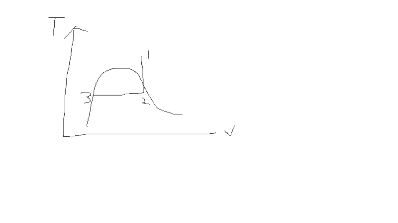

ya. i just drew a new diagram, I sketched from point 1 and through the line to point 2.
Much better. Now, what are the mass fractions of liquid and vapor at point 2? What is the specific internal energy at point 2?
