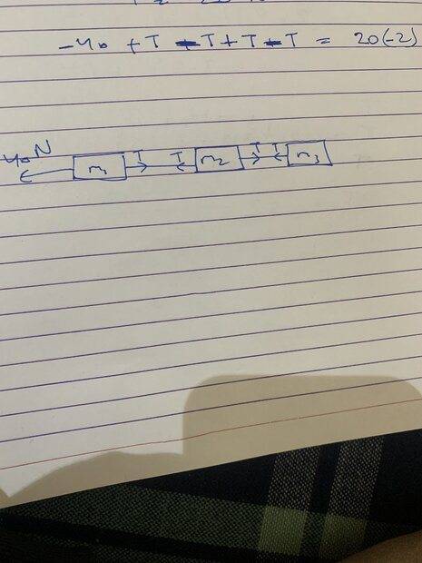

Three blocks of mass 10, 6,4 kgs are placed on friction less surface. Force of 40N pulls the system. Calculate T.
##F=ma##
$$a= -40/(10+6+4)$$
$$a=-2 m/s^2$$
Taking one mass of 10 kg.
$$T-40=10(-2)$$
$$T=20 N$$
This is correct.
But if I make the eqn of the system then
$$-40+T-T+T-T=20(-2)$$
I have also drawn the diagram. It looks like the second body m2 is subject to no force. But it’s accelerating. How?
Your assumption that the tension in all strings is the same is wrong.
If you say that the mass is accelerating and the diagram you drew shows that it isn't, then either you are wrong or the diagram you drew is wrong. Which do you think is the case?
First of all there is no friction. The system will accelerate.
Does tension depend on mass?
So what? My statement did not assume that there was.

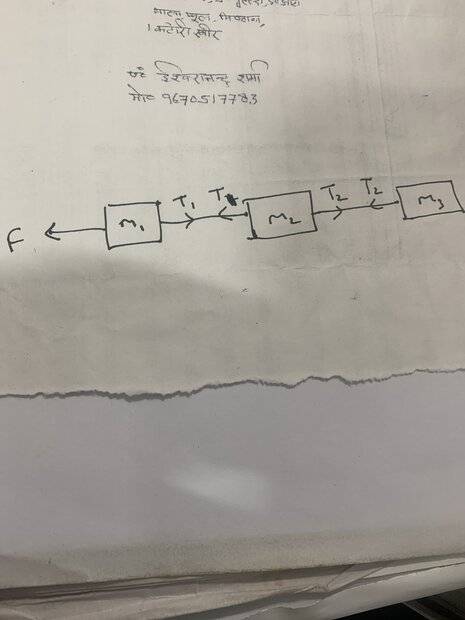

So I calculated T1= 20N
And T2= 8N.
And this tension is due to force 40N and inertia of the masses since there is no friction?
Isn’t tension due to all masses, applied force and friction ?
And T2= 8N.
These numbers are correct.
Yes, in a sense. The three masses subdivide the 40 N net force in the following manner
$$Ma=(m_1+m_2+m_3)a=m_1a+m_2a+m_3a=(20+12+8)~\text{N}=40~\text{N}=F_{\text{Net}}$$The difference between the two tensions acting on the middle mass must be equal to ##m_2a##. That's what you missed when you started solving this problem.

20N is tension in first string and 8 in second. What is 12N. You say it’s the difference in tensions on mass m2.
So this is not the tension in string? I don’t understand! It should be in the strings.
The free body diagram for m₂ [edit - ignoring the vertical forces which cancel] is:
T₁←[m₂]→T₂
From this free body diagram, you can see the net force on m₂ is T₂ – T₁
##F_{net,2} = T₂ – T₁ = 8 – 20 = -12N##
That means m₂’s acceleration is
##a = \frac {F_{net,2}} {m ₂} = \frac {-12} {6} = --2m/s^2## as expected.
So it all makes sense..
You are tripping over your own two feet.
Mass m1 is pulling to the left on m2 with a force of 20 N. This is T1.
Mass m3 is pulling to the right on m2 with a force of 8 N. This is T2.
To the left is negative and to the right is positive, so T1 = -20 N and T2 = +8 N.
The net force on m2 is the sum:
Fnet = T1 + T2 = -20 N + 8 N = -12 N
Mass times acceleration for m2 is m2*a = 6 (kg)*(-2) (m/s2) = -12 N.
See how Newton's second law works for m2?
Yeah! So it depends on the applied force. Since applied force is in left of 40N ,tension in every string is due to m2 and m3 for T1 and m3 for T2.
You will have better success solving these problems if you desist from trying to take a holistic view. Yes, there are times when that can be a faster route, but it seems to mislead you too often.
Separate it out into a free body diagram for each rigid body. Relate them only by the forces that act between directly connected bodies and the motions they must share. Keep in mind that each body only "knows" about the forces that act directly on it. Likewise, the action and reaction between two connected bodies don't "know" anything about other action/reaction pairs in the system.
So here you have ##T_{12}## acting between ##m1, m_2##; ##T_{23}## acting between ##m3, m_2##; the force 40N acts only on ##m_1##; and all three having the same acceleration, ##a## in the direction of the applied force.
From that you can write a ##\Sigma F=ma## equation for each block, and you have three unknowns. Solve.
