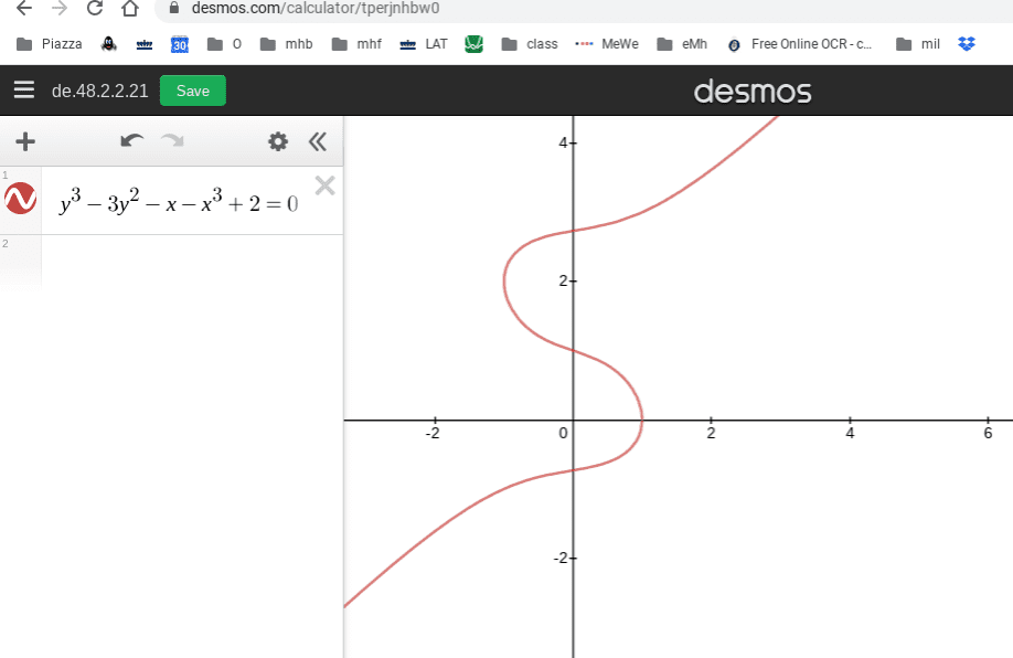

ok i tried to plot $y^3−3y^2−x−x^3+2=0, |x|<1$ but could not do so
spent about an hour trying to find a useable example but didn't
i am new to tikz but this is not a function...
here is the code I tried. just borrowed a previos on i thot I could just replace the expression but no

TikZ does not support plotting graphs of equations natively.
Instead we can for instance parametrize the equation as:
\begin{cases}
x = r(\phi)\cos\phi \\
y = r(\phi)\sin\phi + 1
\end{cases}
where $r(\phi)=\sqrt{\frac{3\sin\phi+\cos\phi}{\sin^3\phi - \cos^3\phi}}$.
Then we can draw:

For reference, I derived the parametrization as follows.
We can see the point symmetry around (0,1) in the Desmos graph.
Shift the point of symmetry to the origin by introducing $\tilde y = y-1 \implies y = \tilde y + 1$.
Consequently we get:
\begin{aligned}y^3-3y^2-x-x^3+2&=
(\tilde y+1)^3-3(\tilde y+1)^2-x-x^3+2 \\
&=\tilde y^3+3\tilde y^2 +3\tilde y + 1 -3\tilde y^2 - 6\tilde y-3-x-x^3+2 \\
&=\tilde y^3-3\tilde y-x-x^3 \\
& = 0\end{aligned}
Substitute polar coordinates $x=r\cos\phi,\,\tilde y=r\sin\phi$ to get:
\[ \tilde y^3-3\tilde y-x-x^3=0 \\
(r\sin\phi)^3-3(r\sin\phi)-(r\cos\phi)-(r\cos\phi)^3=0 \\
r^3(\sin^3\phi - \cos^3\phi)=r(3\sin\phi+\cos\phi) \\
r=\pm \sqrt{\frac{3\sin\phi+\cos\phi}{\sin^3\phi - \cos^3\phi}} \quad\lor\quad r=0 \]
In polar coordinates we have that $r\ge 0$, so we will only have the $+$ solution.
Putting it together we get:
\begin{cases}x = r(\phi)\cos\phi \\ y=r(\phi)\sin\phi +1
\end{cases}

I see where $|x|<1$ comes from now.
However, it is not enough to just restrict $x$. It also means that we have to restrict $y$ to the interval $(0,2)$.
That is because the top and bottom parts of the previous graph do not have $y(0)=1$, so they have to be left out.
Since $y'$ has a very different y-range, I guess it is best to put it in a separate graph.
