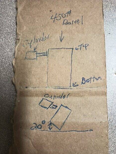

I'm trying to tilt a 450 pound plastic drum to a 20 degree angle using a pneumatic cylinder. Need to determine what size and how many to use.
I have been tasked with tilting a plastic 55 gallon drum that contains lube to an angle of about 20 degrees.
I would like to use pneumatic cylinders as air is readily available here.
The plastic barrel has a 23.5 inch diameter and is 35 inches tall.
The barrel and contents weighs 450 pounds.
What force is required to tilt the drum?
Thanks,

Center?
I was wanting the tilt cylinder to be in contact near the top of the drum... on the side... at say the "6 o'clock" position... and the barrel would tilt over onto the bottom edge of drum located at the "12 o'clock" position.
(if viewing the drum from overhead)
The drums are standing upright.
This is a straightforward torque equality (or rather, sum to zero). The barrel is full and has a center of gravity in the middle. Maximum torque is when it just starts to tilt. Torque is just force times moment arm length:
F1L1 + F2L2 = 0

Here is the answer to your question: about 150 lbs from the pneumatics will tilt the full barrel.
But as others have said that is probably not a good design. You need to optimise.

I was planning on using a 3/8" metal plate a couple inches across and 10-12 inches tall (with rubber or UHMW plastic layer) to distribute the force.
As far as the barrel rolling, spinning, etc I was going to build a frame on casters that would cradle the drum on 3 sides.. (still trying to figure out exactly how)
