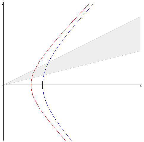

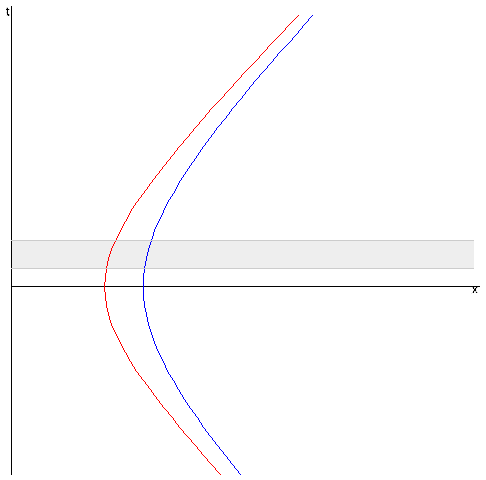

Here is why simultaneity matters. I have sketched a Minkowski diagram showing the worldlines of the front (blue) and rear (red) of a rocket, and added a pair of fine grey lines showing two consecutive clock ticks in the inertial frame in which the rocket was at rest at some time. In this frame, the ratio of clock rates is the ratio of proper times along the two worldlines between the grey lines (in the shaded area).
Now, here's the same diagram but showing two simultaneity planes in the rocket frame. Again, the clock rate in this frame is the ratio of the proper times in the shaded areas.
Hopefully it's obvious the red and blue lengths in the shaded areas aren't the same in the two diagrams. Apart from anything else, the value in the rocket frame will be independent of time, but the value in the inertial frame will not be. So what simultaneity criterion you use matters.
(Note that the above diagrams are an approximation - the clock rate is actually the limit of the ratio as the simultaneity planes get close to one another.)
Likes topsquark and PeterDonis
