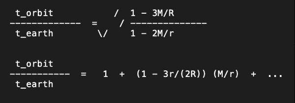

I was watching a video on GR by mathematician Matt Parker (he of the Parker Square) where he corrected some general misconceptions about GR. Most of the video wasn't anything special but there was one concept that stood out to me: the time-dilato-pause.
The idea behind it is quite simple: for any satellite orbiting a massive object, there are two time dilations at work: one from SR because of how fast it's moving in its orbit (speed dilation - SD) and one from GR because of its position inside a gravitational well (gravity dilation - GD). The time dilations are measured relative to the surface of the massive object.
SD and GD are in opposition to each other because SD tries to slow time down whereas GD tries to speed time up (again, relative to the surface). So the thinking goes that at some distance from the surface, SD and GD cancel each other out and the satellite experiences time at the same rate as the surface. This distance is termed the time-dilato-pause and someone calculated that it lies at a distance of 1.5R from the surface of the object, with R being the radius of said object. Actually, the original calculation was for the earth but I'm sure it can be generalized to any massive object.
Anyway, it ocurred to me that this was significant because it would allow the satellite to experience the same time dilation as on the surface of a massive body (relative to a farway stationary observer) without actually being on the surface. So naturally, my first thought was black holes. If there is indeed a time-dilato-pause at a distance of 1.5R from the event horizon, would a satellite orbiting at that distance experience the same time dilation as the event horizon, i.e. infinite time dilation relative to a faraway stationary observer?
The orbit would be well inside the innermost stable circular orbit (ISCO). However, provided we give it energy from the outside continuously, the satellite would be able to maintain the orbit and escape, basically experiencing what crossing the event horizon would be like without actually crossing it.
So is this actually possible or is there something that I haven't accounted for?

It isn't, at least, not the way you are interpreting ##R## and ##r##. See below.
PeroK said:
a forced circular orbit at ##1.5R## has a valid calculation for the total time dilation
Not for a black hole, since such an orbit is null, not timelike. Similarly, a worldline "at the event horizon" is null, not timelike. The concept of "time dilation" does not apply to null worldlines.
This becomes immediately evident when one correctly interprets the first formula in the image in post #4: ##R## in that formula should be the Schwarzschild radial coordinate of the circular orbit, and ##r## should be the Schwarzschild radial coordinate of the surface of the massive object. With that interpretation, that formula is exact in GR. And it makes it obvious that, for a circular orbit at ##R = 3M## (the photon sphere, 1.5 times the horizon radius) around a black hole (##r = 2M##), the formula is undefined: both the numerator and denominator are zero. (On the OP's interpretation, with ##R## being the radial coordinate of the surface of the body, we would have ##R = 2M## and the quantity under the square root in the numerator would be negative: obviously wrong.) Furthermore, we can't plug in ##r = 2M## for any case whatever, since that makes the denominator zero--which of course it must since, as noted above, a worldline "at the event horizon" is null, not timelike.
If we consider a static object with ##r > 2M##, however, and circular orbits at ##R > 3M##, the formula is perfectly valid. Actually, by Buchdahl's Theorem, we must have ##r > (9/4) M## for a static massive object, so that is the range we should consider. And if we plug ##R = (3/2) r## into the first formula in the image in post #4, we see that it gives 1. So, for an object at the limiting value ##r = (9/4) M##, a circular orbit at ##R = (27/8) M## would indeed have the same time dilation--and circular orbits inside that value of ##R## (and there is a finite range of them between there and ##R = 3M##, the photon sphere) would have greater time dilation (clocks ticking slower) than an object on the surface of the object at ##r = (9/4) M##.

Feynstein100 said:
Ok, thanks for the link.
Looking at this, I was correct that you had ##R## and ##r## backwards. ##R## is the Schwarzschild radial coordinate of the circular orbit, and ##r## is the Schwarzschild radial coordinate at the surface of the massive object. (Kevin Brown specifies the North Pole in order to remove the issues involved with the Earth's rotation.) But given that, there is no need whatever to expand in a power series in ##M / r##, as Kevin Brown does. You can solve the equation exactly for the ratio ##R / r## that makes the time dilation ratio exactly ##1##; the result is, as I said before, ##R = 1.5 r##.
Wait, so is it applicable to black holes tho? If there's no need for the power series expansion then there's no approximation that only applies to weak gravitational fields, right?
It's exact, but only applicable outside the event horizon. Attempting to apply it to an observer at the horizon is self-contradictory.

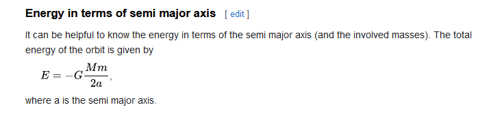

Hang on. That's only true for circular orbits. Perhaps there's some wiggle room with elliptical orbits. After all, satellites in elliptical orbits only move at high velocities when they're very close to the object. Otherwise they move slowly.
Looks like my hunch was right. The energy in an elliptical orbit is given by
The more elliptical the orbit, the larger the semi major axis and the lower the energy needed to be in the orbit.
Of course, with the caveat being that the orbital period is now much longer but I think we can find a sweet spot for it.
And that you'll only experience relativistic velocities for a very short time but that's still better than not experiencing those velocities for any period of time with current technology 😁

But as correctly stated above, the total energy depends only on ##a##, no matter how large the excentricity ##\epsilon## with ##0 \leq \epsilon<1## is. Also the period doesn't depend on ##\epsilon##, thanks to Kepler's 3rd Law
$$\frac{T^2}{a^3} = \frac{4 \pi^2}{G M} \simeq \frac{4 \pi^2}{G m_{\text{Sun}}}=\text{const}.$$
  • #31
But a depends on eccentricity. It's the distance from the focus to the centre of the ellipse. The more eccentric the ellipse, the farther away the centre is from the focus and thus the greater the semimajor axis, right?
Ah okay as long as the endpoints/foci don't change, the eccentricity doesn't affect a. But that's not the image I had in mind. I meant stretching the ellipse outward until a is as large as we need.
